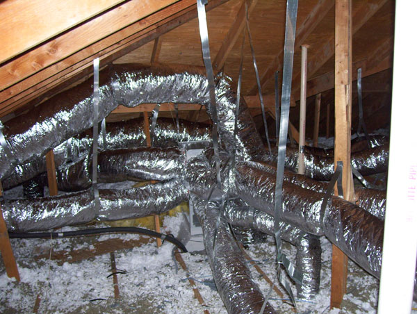

Ducts in the attic may not be ideal, but they're apparently in the cards for C. Clark's new house in South Carolina.

C. Clark is preparing to move from a dry region to Lady’s Island, South Carolina, an area with a warm, humid climate that is the mirror opposite of the climate in Clark’s former home. Clark is highly allergic to mold, and that has him thinking about ventilation, insulation, and his HVAC system.
“I have many questions about HVAC, insulation and ventilation, but will just start with a few,” he writes in a Q&A post at GreenBuildingAdvisor. “If we decide on an exhaust-only system for a new-build home, does also trying to button up the envelope tight work with that type of ventilation?”
He expects to insulate the attic floor with blown-in fiberglass because using spray foam would be too expensive. If he does not insulate at the roof, should he install a radiant barrier to keep attic temperatures down?
“I am very concerned about building in a humid climate [Climate Zone 3], because we are very allergic to mold (bed-ridden allergic for me), so preventing condensation and the mold that comes with it are our primary concern, even over energy efficiency,” he writes. “I read the cellulose insulation can trap moisture, which steered me away from it and to fiberglass. If any condensation build up can happen in attic, I don’t want cellulose to be a mold culture.”
He anticipates that ductwork will be located in the attic because his builder has warned that building chases for them inside the building envelope would be too expensive. As a result, he will be looking for the best way to insulate the ducts.
Those are among the issues for this Q&A Spotlight.

    Lowest hanging fruit
    Mr. Clark is planning to build in a relatively mild but humid climate and his overriding concern is avoiding mold conditions. As he has a limited budget and a builder inexperienced in high performance homes I respectfully suggest that the attic distribution ductwork while imperfect is not critical to this issue. The most common and likely source for condensation and mold contamination that we find in the humid southeast is from leaky ductwork in a ventilated crawl space, and by far the most direct route to curing such a deficiency is to encapsulate that crawl space. This is now a straightforward and well documented technology, easily priced, which even tract builders have started to recognize as standard practice. Mr. Clark's attic ductwork may add a little to his power bill but it won't ruin his health. The crawlspace is where he needs to spend his upgrade budget.
