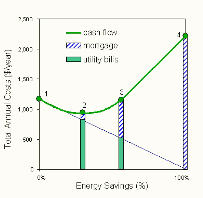

While you can build a decent house, or even a PGH, without energy modeling, using it has several advantages, and it’s not that hard to do once you learn how. What I find most useful is being able to optimize construction details by comparing the effect different assemblies will have on a building’s energy usage. Energy modeling also helps fine-tune window specifications for the lowest energy use, and determines heating and cooling loads for the house, among other options.
BEOpt software user interface
This graph shows how BEopt software can help designers optimize the envelope design of a house. The X axis shows energy upgrade options; the Y axis shows total annual costs for a homeowner. Energy-efficiency measures can lower total costs to the owner of a new home—up to a point. Beyond that point, further investments in insulation or better windows will result in higher mortgages costs—more than the energy savings justify. Source: NREL
For anyone trying energy modeling software for the first time, BEopt, a free software from the National Renewable Energy Laboratory (NREL) using the U.S. Department of Energy’s Energy Plus modeling program, is good and relatively simple. It has an optional feature to automatically determine the most cost-effective path to reaching net-zero operation. You can also use it to balance expenditures and gains and to help calculate return on investment. In many jurisdictions you will need Manual J calculations for heating and cooling, and they are important for right-sizing HVAC equipment, but BEopt does not provide Manual J outputs.
Ekotrope, Wrightsoft, and REM/Design are a few professional-grade programs. Some BIM (building information modeling) programs also have energy plug-ins. Passive House practitioners use the PHPP or WUFI Passiv energy-modeling programs, which are labor-intensive to use but preferred for extremely low energy–use homes.

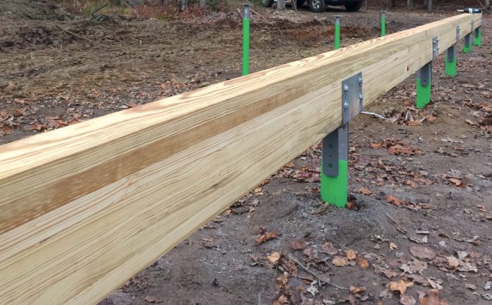

R-40 pier foundation
A pier-and-beam system using helical metal piers or concrete piers have much lower upfront carbon emissions than a full concrete foundation. Piers are located to carry wood beams to support the floor framing. When the top of helical piers are more than a few inches above grade they need bracing, so I’m showing a bolster system to create the height needed to allow code-minimum 18-in. clearance from grade to the bottom of the floor system. (Pressure treated beams don’t need to meet that clearance requirement.) The beams are inset enough to allow for ventilated skirting—the more airflow, the better.
Helical piers
A wood-framed floor assembly supported by helical piers doesn’t require any rigid foam or spray foam insulation. The joist bays can be insulated with dense-packed cellulose or blown-in fiberglass. Photo courtesy of Dan Kolbert
The floor system can be dimensional or engineered lumber; I prefer I-joists because the narrow webs nearly eliminate thermal bridging, allowing for about R-40 for the whole floor system when insulated with dense-packed cellulose, wood fiber, or fiberglass.
To keep out air and critters, 1⁄2-in. sheathing is installed below the joists and sealed to the beams. (If you’re in an earthquake-prone zone, this system may not work for you, but it pairs well with a partial basement that can provide additional lateral support and a place for utilities.)

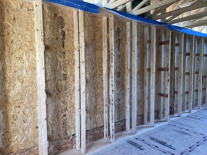

R-40 double-stud walls
Builders have strong feelings for or against double-stud walls, but they have a long track record in New England, and the builders I work with tend to like them. In a cold climate, they need to have ventilated rainscreens so they can dry easily to the exterior. Dense-packed cellulose or wood fiber are ideal insulation materials for this type of wall.
Double-stud 2x4 walls ready to receive dense-pack cellulose insulation
Double-stud 2×4 walls ready to receive dense-pack cellulose insulation. Photo courtesy of Peter Engle
In cold climates, I am most comfortable when a variable-permeance membrane is used at the interior, though many builders just use painted drywall. (Often called “smart” membranes, these products are made from plastics whose vapor permeability changes with humidity levels.) With a 12-in. insulation cavity, the wall will perform at about R-40. The taped sheathing doubles as the air control layer.
