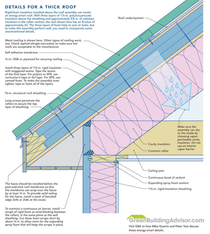

Attics are a great place to reclaim living space without the expense of an addition. If you have the headroom, you can gain at least one extra room by finishing your attic.
But with energy codes requiring more and more insulation, it can be difficult to pack all of that R-value into the skinny little rafters that are common in older houses.
One solution is to add layers of rigid foam under the rafters, but this cuts in to living space. A better solution is to add layers of foam to the outside of the roof. This not only boosts the roof’s R-value, but it breaks the thermal bridge of the rafters and increases the air-tightness of the whole roof assembly.
The takeaways:
1. The higher the R-value, the better, and where you put the insulation matters.
2. Exterior insulation solves a lot of thermal nosebleeds, but the amount of foam you put on the outside needs to be proportional with the amount of insulation on the inside, within the rafter cavity. You need enough exterior foam to prevent condensation on the inside of the roof sheathing by keeping that plywood warm.
3. Is it a good idea to make an unvented roof with a lot of foam on the outside? Yes. Roofs are like walls that are severely out of plumb, and an unvented wall can work.
Just make sure that you don’t do it willy-nilly: if you are going to ask more of your buildings, you need to ask more of your details.
For more roof design details, browse the detail library in the roof/wall connections section.

Detail Question
I'm working on a house design in Zone 5A. Site conditions prevent a basement, so it will be slab on grade thus storage will be needed, suggesting a conditioned attic.
In this detail, the rafter tails are seemingly cut flush with the outside face of stud.
1. What is the grey triangle into which the fascia and soffit are nailed?
2. If the fascia need replacing down the road, is it a nightmare that the peel and stick wraps down onto it?
3. The 2 upper long screws are always into wood (the rafters). Is the lowest screw hitting wood (the gray triangle) or a void?
Thanks,
John Rockwell
Response to John Rockwell
John,
Q. "What is the grey triangle into which the fascia and soffit are nailed?"
A. That is the rafter tail. The rafter extends to the soffit; there is a bird's mouth cut to accommodate the top plate of the wall.
Q. "If the fascia need replacing down the road, is it a nightmare that the peel and stick wraps down onto it?"
A. No. Replacement of the fascia shouldn't be difficult. The peel-and-stick membrane only laps the fascia by 1/2 inch.
Q. "The 2 upper long screws are always into wood (the rafters). Is the lowest screw hitting wood (the gray triangle) or a void?"
A. The screws extend into the rafters. The gray triangle is a rafter tail.
Response to John Rockwell RE: Rafter tail
Do you really want to extend your rafters past the thermal envelope & create a thermal bridge if you're really concerned with thermal performance and avoiding condensation in the rafter bays/cavities. I know it seems like a small point, but if you're going to all the effort, i.e. money, to create this great assembly, Why not take it a small step further and eliminate that thermal bridge?
Some other comments about the detail. 1) No exterior sheathing is shown or mentioned. I know you can eliminate it, but a lot of code officials would probably nix a structure without some sort of sheathing. 2) The transition between the attic floor/ceiling joists isn't really shown. How are keeping all that nice cellulose in place? 3) If the attic was actually going to be used as finished space, that transition between the floor joists and rafters is even more important and even harder to detail and finish. Suggestions.

I am trying to design a roof structure for my outbuilding (to be used partly as a music practice room, and therefore will ideally be as 'soundproof' as possible). I like the idea presented here as it seems to allow for plenty of insulation and at the same time avoids ventilation spaces through which sound would leak out.
But I wondered i it would be possible to increase the thickness of OSB, and possibly use double layers, in order to increase mass. Or would this compromise the ability of moisture to escape to the inside of the structure? And (just to check), I am guessing that Moisture-resistant OSB would not be appropriate for this type of roof?
Thanks in advance for any guidance. Jon.
Response to Jon Burton
Jon,
The roof illustrated on this page has two layers of OSB sheathing -- one under the rigid foam, and one above the rigid foam -- just like a SIP. (In fact, many builders find it easier to install SIPs to create this type of roof.)
It's perfectly possible to make either OSB layer thicker if you want to. I have no idea whether thick (or doubled) OSB will help reduce sound transmission. Moisture does not need to cross these OSB layers.

Thanks a lot for your reply, Martin. I was just interested in using the OSB (or any dense sheet material) to add mass and thus improve the sound proofing of the roof. I now see the similarity with SIPs - didn't notice that at first.
I'm based in the UK, and the amount of rigid insulation above the rafters required may be different here to that used in the diagram: is there any way to calculate a target R value for this rigid inuslation? Where I am, average minimum winter temperatures would get down to freezing temperature at night (with absolute minimums of around -2 degrees C or 28F. I wondered whether there was a formula available to work this out (as I need to minimise roof-level increase).
