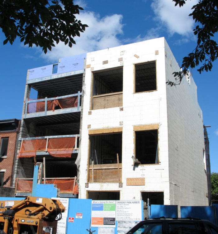

A four-story, three-unit walk-up
R-951 (named for resilience, R-value, and the address: 951 Pacific Street) is being built on a narrow lot in a neighborhood of three- or four-story row houses. The three-unit row house is tall and narrow, but with a remarkable amount of outdoor space. The first-story apartment includes a sizable backyard along with half of the basement space (the rest being common space for the three units). The second-story apartment includes a small front balcony and larger rear balcony plus an upper-level loft bedroom. The upper unit is also on two levels and includes front and rear rooftop terraces along with a small front balcony.
Each unit is about 1,500 square feet. Because the project is designated as a green building by the City, there was a 500 square-foot bonus provided to the developed area. “That is huge,” Paul told me, in that it allowed the addition of the terrace space.
The building is insulated with insulated concrete forms (ICFs) and lots of additional polyisocyanurate foam insulation. The exposed north and south walls are insulated to about R-46, the roof is insulated to R-59, and there is R-21 insulation under the basement slab.
Windows are state-of-the-art triple-glazed, vinyl-framed Schüco units from Germany with NFRC U-factors of 0.15 and remarkable 0.71 visible transmittance. In other words, these windows allow less than half as much heat loss as standard, American double-glazed windows with low-emissivity glass and argon gas fill, yet they are just as clear or even clearer. The solar heat-gain coefficient (SHGC) is 0.50 — allowing plenty of solar gain for passive solar heating benefits.
Preliminary energy modeling using the Passive House Planning Package (PHPP), done by Grayson Jordan in Paul’s office, came out at 4.80 kBtu/ft2·year, which is slightly higher than the Passivhaus threshold (4.75 kBut/ft2·yr), but Paul thinks that with some tweaks to the envelope during construction the project will meet the Passivhaus requirements.
