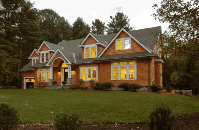

An award for the most innovative single-family green home. This four-bedroom house in Weston, Mass., was the gold award winner for most innovative single-family green design in this year's PRISM competition.

The Weston, Mass., house built by Kingsbury Homes Limited and designed by HDS Architecture has more than 5,500 sq. ft. of conditioned space but a total heating load of 35,000 Btu/hour.

A four-bedroom home in Weston, Mass., built by Kingsbury Homes Limited, won the gold award for the most innovative single-family green design.

It’s even bigger than it looks
Kingsbury’s entry is a spec-built home with four bedrooms and four baths on the upper level, two half-baths on the first floor and another full bath in the basement. The house measures 4,200 sq. ft., with an additional 1,500 sq. ft. of finished space in the basement.
“At 86 ft. long, this rambling stretched-out cape is not the usual compact rectangular design typically found in a super insulated home,” an online description of the project says.
Kingsbury’s Franz J. Burke says the idea was to build a “green home that doesn’t look like a green home.” It was designed by Keith Gross of HDS Architecture of Cambridge, Mass.
Features include double-stud wall construction, insulated to R-40 with open-cell polyurethane foam, and a foam-insulated R-60 roof. The basement walls and slab are insulated to R-20. The house has triple-glazed windows, a heat recovery ventilator, and a high-efficiency gas furnace. Air leakage was tested at 0.97 air changes per hour at a pressure difference of 50 pascals (ach50).
Burke says the house has a HERS Index of 37 and a heat load of 35,000 Btu/hr.
Burke is a former bank appraiser who has been building houses only since 2006. The Weston house, his sixth or seventh project, was built on spec and later sold for $1.94 million.
