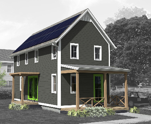

A four-bedroom, two-bathroom house its designers named “The Little Green Rhody” has won top honors in a design competition that promotes affordability, reduced fossil fuel use, and a lower carbon footprint.
The Carbon Challenge Providence Design Competition, sponsored by LP Building Products and Boise Cascade, was based in Providence, Rhode Island, but was open to anyone in the U.S. A total of 144 designers submitted entries to the competition and a simultaneous contest in Baltimore, Maryland. Judges looked at each entry’s carbon footprint, its use of wood, its cost effectiveness, and its appearance, organizers said.
The Providence entries were designed as a Habitat for Humanity project to be built on a vacant lot at 24 Hannah Street. The winning entry is the work of ZeroEnergy Design in Boston.
The 2,000-sq.-ft. net-zero-energy house has an uncomplicated style and a simple, gabled roof. It was considered a good match with traditional architecture in the neighborhood. Among the construction details provided by ZeroEnergy Design:
- The R-27 walls are framed with 2x4s on 16-in. centers. The stud bays are insulated with mineral wool or cotton batt cavity insulation. In additon, the exterior of the walls is insulated with a continuous 3-inch-thick layer of mineral wool insulation, which has a “low global warming potential, is not a petroleum-based product, and does not expand and contract like foam-based insulation products.”
- Basement walls are manufactured by Superior Walls of America placed on a rubble footing rather than a poured concrete footing and insulated with expanded polystyrene (EPS) insulation rather than extruded polystyrene (XPS) because of its lower global-warming potential.
- The roof is framed with raised-heel trusses, 24 in. on center. The floor of the vented attic is insulated with 14 in. of loose-fill cellulose for an R-value of 52.
- The European windows are triple-glazed. Door lights are also triple-glazed.
- The air barrier for the walls consists of taped Zip System wall sheathing.
- A 7.5-kW solar electric array is specified for the south-facing roof.
- Domestic hot water is provided by a heat-pump water heater.
- Space heating and cooling are provided by an air-source heat pump. Mechanical ventilation is provided by a heat-recovery ventilator.
Adam Prince, one of three owners of ZeroEnergy Design, said the design team estimated the house would cost about $8,000 more than a code-minimum structure of the same size. (That estimate did not include the cost of the roof-mounted PV array.)

Here's one interesting observation, which of course has been made before. Amortizing that extra $8,000 of building cost over a mortgage @4% costs $48.48/mo (20 years) or as low as $38.19/mo (30 years). The average monthly saving on energy from the numbers cited is $182.67, of which at least $125/mo was the heating saving. The cost of ownership is lower for the more expensive house. In approving mortgage loan applications, a bank really ought to quit using PIT (principal, interest, taxes) as some percent of income (30%?) and start using PITE, the "E" meaning energy. In the above case, it would lower the bank's risk to approve the more expensive but superinsulated house vs code minimum.
What HE said...
+1 on Dicks PIT-E vs. PIT assessment of the financials! Even if there is significant energy price deflation over the coming decades (not likely) PIT-E is simply a better metric for the viability of the loan on day-1, and hedges against future energy price inflation (more likely, but not guaranteed.)
Response to Dick Russell and Dana Dorsett
Dick and Dana,
I agree that a more expensive house can save money and (if the incremental costs are financed) result in positive cash flow from from Day One.
That said, I'm a little suspicious of the $8,000 figure for the estimated incremental cost. First of all, this house hasn't even been built yet. Second, it's going to be hard to find a contractor to install a 7.5-kW PV system for less than $30,000.
Martin, I too am skeptical as
Martin, I too am skeptical as to whether the 8K included anything but the house framing and insulation. Assuming that, the numbers for just heating are quite realistic, for an immediate savings of at least $87/mo over 30 years or 77 over 20. I wouldn't expect the numbers for adding on the PV upgrade to have immediate payout. Perhaps Mr. Gibson can comment, or someone from Zero Energy Design, if they are tuned in.
The estimate was the increment for the base design
The base design is simple which helps to make it more affordable to build - it's four corners with a gable roof, a reasonable starting point. Affordability was one factor of several in the competition, but not the sole determinant.
As we mentioned to Scott, without factoring in the possibility of in-kind or discounted materials (this is a Habitat house), we estimated the premium for the materials (insulation, HRV, better windows, better hot water heater, etc) in the base design without the PV. Sorry if that wasn't clear. This is the estimated cost increment compared to code minimum. We haven't received feedback from Habitat as to how the cost of this base design compares to their existing designs.
