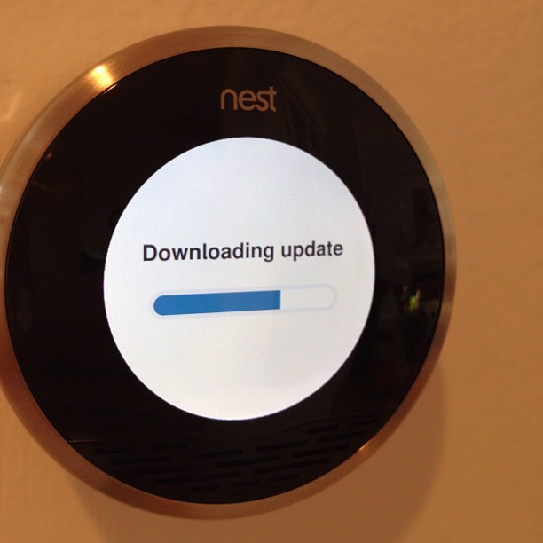

The Nest Learning Thermostat lets homeowners control temperatures remotely via an internet connection, the same feature making automatic software updates possible. But an update in December came with a bug that caused some thermostats to malfunction two weeks later, in some cases turning off the heat in the middle of the night.
The New York Times was the first to report the glitch earlier this month, noting that an unknown number of the $249 thermostats went on the fritz. A malfunctioning thermostat could pose serious problems for people who had installed one in a second home where pipes could freeze and burst, The Times noted, or to older or ill people without much tolerance for cold temperatures.
The problem stemmed from a software update that the company pushed out in December. It contained a flaw that didn’t start appearing for another two weeks. The company didn’t say how many users were affected, but said the issue has since been resolved for almost all customers.

In a statement posted at its website, Nest said that some thermostats updated to software version 5.1.3 or later “may become unresponsive or may not charge the battery efficiently, causing it to shut down.”
Nest suggested that customers recharge and restart the thermostat. If the thermostat was on but running slowly, or if the thermostat could not be controlled, a simple reboot should do the trick. If the thermostat was off and could not be turned back on, the company outlined a nine-step process to set things right.

Nest failure was the perfect storm of dumb HVAC "brain" interacting with much more powerful "brain" in Nest. There is no such thing as bug-free software, just like building science isn't without failures. Deep details of the issue weren't published, but having seen something like this before, it was likely issue isolated to those without Common wire. Nest tries to charge by scavenging from other power inputs and some HVAC boards cut off the power. Something in charging algorithm set off chain reaction in certain HVAC untis.
