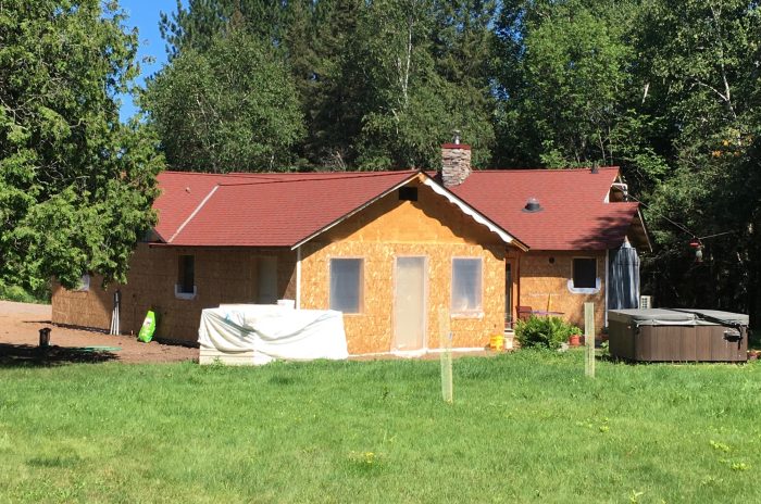

Nailbase installation
The retrofit project pictured here benefitted from the use of nailbase panels. The owners were uncomfortable in their leaky, underinsulated 1960s ranch home, and their energy bills were high, but they loved their house and its location. They—and the house—were ready for some improvements.
The existing wall assembly included 2×6 studs sheathed with T1-11 plywood; installation was too close to grade, which resulted in rotting structural wood. Conditions included a former attached garage that had been converted to living space; it was insulated with closed-cell spray foam. The rest of the house had poorly installed fiberglass insulation. The presence of…
