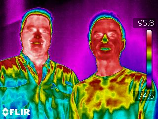

If you think I look silly in the adjacent photo, I am here to warn you that thermographic imagery will make us all look silly if we do not take stock of the power it holds in the hands of homeowners. In the next two to three years, it will change the way we all look—and the way our houses are built—more than ANY other technology to hit our industry since power tools.
