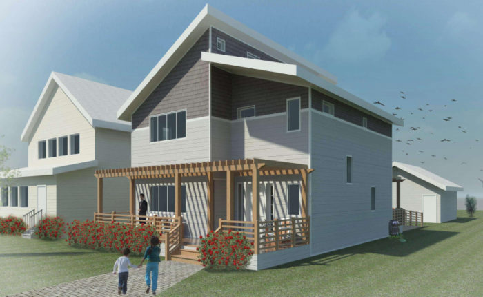

A team from the University of Minnesota submitted this entry in the Race to Zero competition sponsored by the U.S. Department of Energy. The "OptiMN Impact Home" won top honors.
Image Credit: DOE
A team of students from the University of Minnesota came up with the winning entry in this year’s Race to Zero competition with a 2,544-square-foot two-story house designed to be affordable as well as energy-efficient.
The OptiMN Impact Home was designed specifically for infill lots in North Minneapolis and meets both the Department of Energy’s Zero Energy Ready Home criteria and a program established by the city of Minneapolis called Green Homes North. The project was a collaboration between the university and Urban Homeworks, a neighborhood development program in Minneapolis.

The house is designed for a 40-foot-wide lot with its long axis aligned east-to-west, to make the most of solar gain. With most Minneapolis house lots running east-to-west, the team said, the design would be well suited to the area.
Among the features of the winning design are Energy Star appliances and windows, WaterSense low-flow plumbing fixtures, rainwater storage, LED lights, photovoltaic panels, low-VOC paints and finishes, and concrete made with fly ash.
The total finished floor area is 1,696 square feet with another 848 square feet in a lower level that also could be finished. The design includes three bedrooms and 1 1/2 bathroom (plus another in the lower level).

  1. charlie_sullivan | | #1
    Well done. XPS?
    This is a nice design. It's great that this competition aims for cost effectiveness and good design as well as energy efficiency, and it seems like a good design that balances the different objectives well.
    It's a little ironic that this design, using XPS, appears on the same day as an article telling us about how the XPS industry is dragging their feet, opposing efforts to reduce the global warming impact of their product. It's unfortunate that the design criteria for the competition were not broad enough to require considering that impact.
    I'm also curious about the choice of low SHGC windows. Was that really the best choice for this climate, or was it driven by the fact that the low-cost window manufacturer chosen doesn't offer a high SHGC option?
    Congratulations to the students. The building industry will be improved as people like them go into the field.
