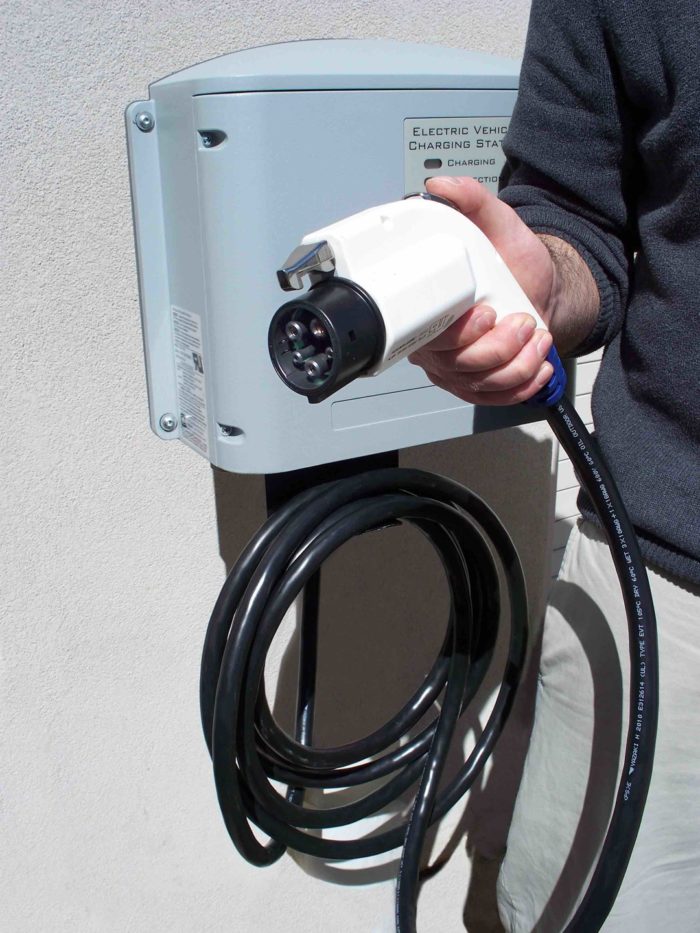

Minnesota now requires investor-owned electric utilities to offer special rate plans for owners of electric vehicles.
UtilityDive reports that the Minnesota Public Utilities Commission took the step because of increased interest in electric vehicles (EVs) but decided to apply it only to investor-owned utilities and not to publicly owned utilities.
At the same time, regulators also approved a surcharge for customers who want all of their EV electricity to come from renewable sources.
The Public Utilities Commission decision follows by about a year the passage of a state law requiring investor-owned utilities to file proposed tariffs allowing customers to buy electricity solely for the purpose of recharging their EVs. Utilities were permitted to offer either a time-of-use rate or an off-peak only rate, according to briefing papers on file with the commission.
Utilities responded to the May directive in different ways. Minnesota Power began offering summer and winter off-peak rates of 4.332 cents per kWh, UtilityDive said. Otter Tail summer off-peak rates were set at 2.962 cents/kWh, with its winter rate at 4.661 cents/kWh. Xcel Energy’s off-peak rate is 3.3 cents/kWh; its peak rate is between 14 cents and 17.5 cents/kWh.
Two of the utilities won’t allow EV charging during peak hours.
Encouraging EV owners to plug in during off-peak hours will help level off some peaks of residential power consumption while giving the utilities a boost in overall demand, the commission’s staff noted:
“If the EV tariffs are well designed and marketed, EV charging during off-peak hours will enhance utilities’ operational efficiency (through increased load factors) and will reduce EV owners’ bills by taking advantage of lower nighttime electricity prices,” the briefing papers said.
“If EV owners have no incentive to charge their cars during off-peak hours, it’s likely that most will begin charging when they arrive home, which could exacerbate the ‘peakiness’ of residential demand,” the staff continued. “A Level 2 EV charger uses a typical household service of 240 volts — similar to an electric dryer — and often requires upgrading or adding wiring and other electric equipment wherever the vehicle will be charged.”
