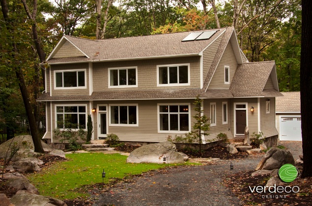

Image Credit: Verdeco Designs, Beaton Construction, and DEAP Energy Group
Image Credit: Verdeco Designs, Beaton Construction, and DEAP Energy Group The house includes a solar hot water system with an 80-gal. storage tank. The building’s airtightness – at 0.49 air changes per hour at 50 Pascals pressure difference – was well within the Passivhaus requirement. Though it wasn’t specified in the design, an unusual amount of cellulose insulation went into the attic, bringing the main ceiling to R-126.2. Exterior walls were insulated to R-65.7 on the first floor, R-58.2 on the second. Basement foundation walls were insulated to R-51.8, the slab floor to R-41.3.
