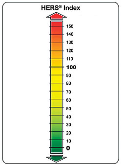

![](http://images.greenbuildingadvisor.com/app/uploads/2018/07/26163844/HERS%20Chart-1-main.jpg)
Image Credit: Residential Energy Services Network

Single-family and multifamily homes built in jurisdictions that adopt the stretch code will need to be third-party certified for a HERS index rating of 60 or less. The current base energy code in Massachusetts requires a minimum HERS rating of 99. For major renovations under the stretch code, a HERS index of 70 or less is required; the requirement drops to a HERS rating of 85 or less where existing heating systems are retained.
