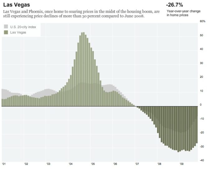

![](http://images.greenbuildingadvisor.com/app/uploads/2018/07/24220921/Homeprices_0-main-700x555.jpg)
Image Credit: Kevin Quealy/The New York Times
On Wednesday, December 30, 2009, the New York Times headline read “New Slip in Housing Prices Undercuts Fragile Optimism.” As disappointing as that may sound, I think that it is a sign of hope for green building. Sustainable building has suffered too long from slow acceptance. This is due, I believe, in large part to the drunken orgy of real estate speculation we were living through for much of the last 20 years. Why should anyone care about the efficiency, durability or health of their home if they were going to flip it for a big profit in a few years, or even months? All most buyers thought about was how big is the house and how fancy are the finishes. The bigger and fancier the better, with rarely a thought given to anything as mundane as the quality of construction or, god forbid, even building a house that is actually the size you need instead of yet another starter castle of 5000 sq. ft. or more. Add to this the mortgage industry’s penchant for loaning anyone with a pulse more money than they could ever hope to repay, and you have all the ingredients for the current real estate mess.
