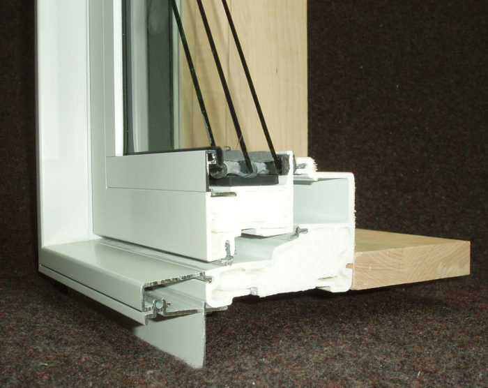

Thermotech window frames are made of fiberglass
Thermotech gave us references for two homes, both in Belfast, Maine. That was convenient, as it allowed us to visit the Belfast Passive house built by G-O Logic, which is also the subject of a previous blog.
The Thermotech windows were installed by different builders. We were able to meet with both builders to get their impressions on the ease of installation, product quality, post installation performance, and any warranty issues that might have arisen. Both homes used Thermotech casement and fixed windows with triple-pane, argon-filled glazing with low-e coatings. One home also featured a Thermotech French door. All the windows had the standard white interior and exterior color.
While windows made of wood, wood with aluminum or PVC exterior cladding, aluminum, and PVC windows are most common, the Thermotech windows are made of fiberglass, more precisely, pultruded fiberglass.
“Pull who through” glass, you ask? Fiberglass is typically manufactured by pushing resin-impregnated fibers through a heated die. Pultruded fiberglass has a higher glass content and is instead pulled through the heated die. This pultrusion process gives the fiberglass much greater strength. A durable exterior finish is added to provide protection from UV damage.
High-solar-gain glazing
I have read a number of articles in prominent magazines that tout protruded fiberglass as the ideal material for windows because of its inherent strength, low thermal conductivity, resistance to rot and insect damage. In addition, its rate of expansion when exposed to heat and contraction when exposed to cold is very similar to that of glass. So the seal between the glass and sash should remain airtight over time as both the fiberglass and glass expand and contract at the same rate. Thermotech’s informational brochure provides an excellent overview on high-performance windows.
From a technical perspective, we found that Thermotech offers the highest SHGC glass (0.64) of the window manufacturers we considered. They attribute the high SHGC to the unique low-e coating they use, and the special way they apply the coating to the glazing.
Glass surfaces (front and back) for triple-pane windows are numbered sequentially from the outside, with the outer pane having surfaces 1 and 2, the middle pane having surfaces 3 and 4, and the inner pane having surfaces 5 and 6. When outside the house you touch surface 1, and when inside the house you are touch surface number 6. Most low-e coatings are applied on surfaces 2 and 5. Thermotech applies the coating on surfaces 3 and 5, which Thermotech explains allows the first argon-filled chamber to get hotter, which enhances the SHGC.
