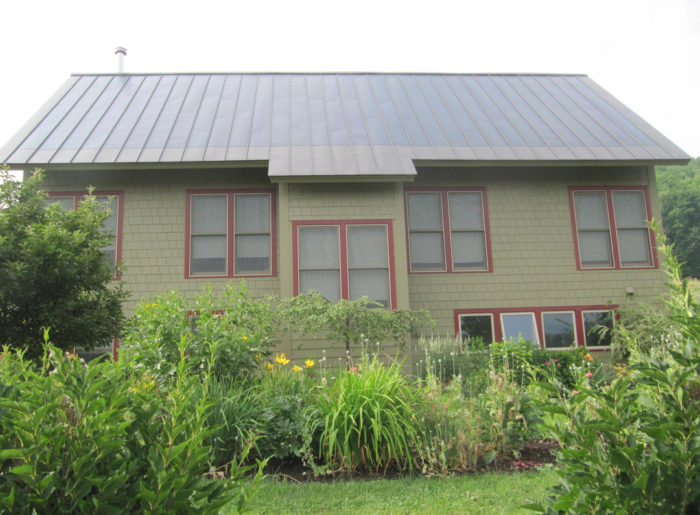

Chuck Reiss, a builder in northwest Vermont, had a bold plan in 2007: he wanted to build a cluster of six superinsulated homes on a 24-arce site in Hinesburg. Reiss planned to install a roof-mounted PV array on each house, with the goal of making the homes net-zero energy, or close to it.
The homes would occupy about 10 acres of the site; the remaining 14 acres would remain agricultural. For anyone interested in passive solar design, the acreage was extremely attractive; architect Rolf Kielman (TruexCullins Architects) describes the sloping site as “a south-facing bowl.” The site is within easy walking distance (via a pedestrian path) of the shops in Hinesburg village.
The project, known as South Farm, now has five homes; the sixth will be built soon. It’s been five years since the first homeowners, David and Carrie Fenn, moved in, so it’s a good time to find out how well the homes have been performing.
Cellulose insulation and roof-mounted PV
Each of the homes that Reiss built is a custom home; however, the homes share many similar characteristics and specifications:

What is the operating life of the solar array, and what would be its replacement cost at today's pricing?
Response to Ron Keagle
Ron,
Most experts assume that peel-and-stick PV arrays like those installed at South Farm won't last as long as conventional glass-framed polycrystalline modules, but no one really knows yet how long they will last.
If you wanted to buy a 3.9-kW polycrystalline (conventional) PV array right now, you'd pay between $18,000 and $20,000.
I have a 32-year-old PV module on my roof that still works perfectly.

Thanks Martin. I know there are no moving parts, so I am just wondering how a photovoltaic array actually wears out, and if manufacturers specify a lifespan of a certain amount of hours of full sun, or maybe specify the amount of electricity produced of the total life. I have heard that the sunlight actually is what wears out the collector.
Ron,
Leaving aside for now the question about amorphous peel-and-stick panels, which have no glass cover and therefore could fail due to UV degradation of the plastic components (I think), here are the ways that conventional polycrystalline modules might eventually fail:
1. The gasket around the glass cover could fail, allowing rain to enter and corrode the electrical terminals.
2. Atmospheric moisture might lead to corrosion of the electrical connections on the underside of the module.
Other than that, we're just talking about glass and aluminum.
