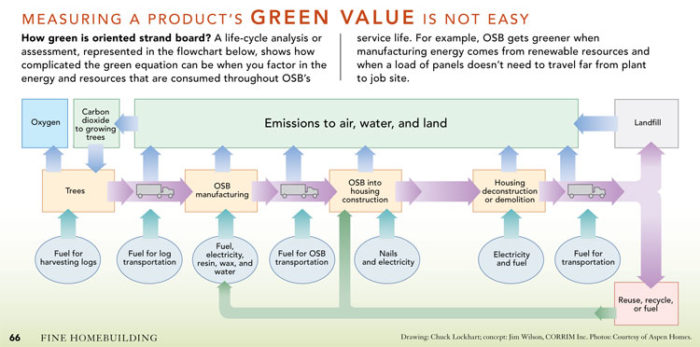

Are steel studs greener than wood? Is plastic pipe greener than copper? And is vinyl siding green? A product’s total environmental impact must be considered.
There are few green building topics that produce more frustration and uncertainty than claims about the environmental footprint of particular building materials. Life-cycle assessments seem like the perfect tool for summing it all up, but they fall short for many reasons.
Getting reliable data is difficult at best
A life-cycle assessment starts with a life-cycle inventory. That includes identifying and quantifying the inputs and outputs of a product from cradle to grave (mining, manufacturing, moving, installing, operating, and disposing of). This is no small task. And because much of the information comes from product manufacturers, the data can be incomplete. Manufacturers may not have all of the information, or they may be unwilling to share it. When all products in a life-cycle-assessment database are not scrutinized equally, conclusions drawn from the information may be misleading.
You can’t predict how many people will actually get cancer, only that a product could cause it
After the life-cycle inventory is put together, it must be translated into actual environmental impacts: global warming, human toxicity, ozone depletion, rainforest degradation, etc. This is called life-cycle impact assessment (LCIA), and it gets pretty hypothetical. Many of these environmental effects require assumptions, such as how many lives will be lost from a particular cancer-causing output. These assumptions are impossible for normal people to evaluate, so we have to rely on someone else’s professional judgment.
