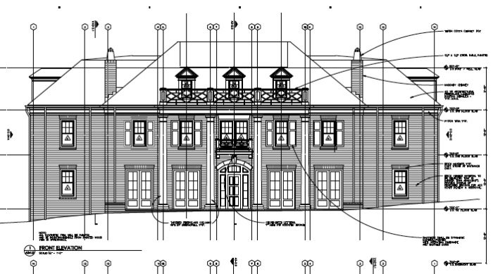

This fraternity house project, while not planned from the start as a green building, was reasonably well thought out, and the design included several high performance features that should make it fairly simple to certify. It is a typical college building with brick veneer, columns, portico, and dormers. No particular consideration was given to solar orientation — which is unfortunate, considering that the building is in a hot southern climate, but not unusual.

In our design review meeting, during a discussion on HVAC systems, the contractor pointed out that while the windows were designed to be operable, the building was designed and engineered to be sealed all the time, with heating, cooling, or heat recovery operating 24/7.
I understand the challenges of managing space heating and cooling in a large building and, from an engineering and management point of view, of not letting the occupants open windows. I’ve seen too many centrally heated buildings with half the windows are open to keep people from overheating during the winter from uncontrollable heating systems. But in a climate where the weather is comfortable and pleasant much of the year, in this day and age, to design a building that uses energy to condition air full time seems to me to be a losing proposition.
They could have designed it with sensors that turned off the HVAC systems when windows are open, along with some training and an effort to engage the fraternity brothers in saving energy. It’s sad that first costs are so important, particularly to an organization that certainly intends to own and manage their building for many years and could benefit from lower operating costs.
