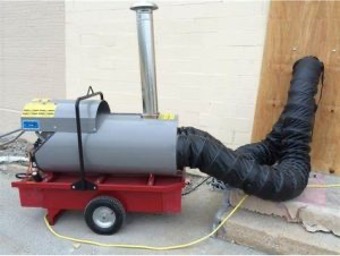

Indirect heating heating system
An indirect combustion system keeps noxious fumes out of the work space.
An indirect heating system is another option. In this case, the fossil-fueled equipment is kept outside the building envelope and a duct moves the heat inside. Combustion takes place outside, so there are no indoor combustion gasses, odors, or associated moisture; there is also less noise inside.

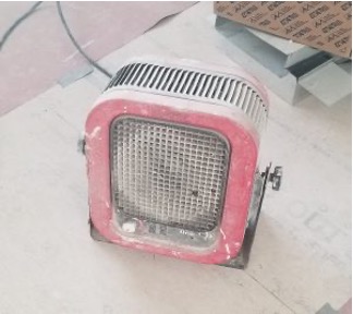

For the concrete-free slab-on-grade home that I was involved with a few years ago, we used two different electric space heaters. The first was a larger unit with two settings, 5000 watts and 3300 watts. We operated it on the 3300-watt setting at night only. During the day, a smaller 1500-watt heater was used. Electric heaters are much quieter than the forced-air torpedo heaters, and they don’t impact IAQ. Their biggest advantage is zero moisture load added to the structure. The disadvantage is the cost. Electricity rates in the area are around $0.14 per kW. At 3300 watts, or 3.3 kW, the cost per hour is a little over $0.45.
Electric heater
A simple electric heater is the cleanest of all options.
Although electric heaters are cheaper to operate, they also have a lower heat output; 3.3 kW produces around 11,250 BTU. We would need nine times that amount to equal the heat output for the larger gas heaters, increasing the cost to $4 per hour, which is roughly the same as the fuel oil heater. Luckily, the amount of heat the electric heaters produced was more than enough due to the robust building envelope—another advantage to building tight, well-insulated homes.

      I've seen that video, great approach for temp heat. There are a few contractors in my area that take that approach (it's rare I see temp AC in my market). The second photo in this post gave me the idea for the article, this was a sub-contractor's temp heating equipment. The RH in that home was 90%, outdoor temps were in the 20°'s with indoor temps varying depending on how close you were to the heater, but the temp near the outside wall was in the low 30°'s, slightly below the dew point. I could not feel any moisture on the plywood sheathed walls, but I'm sure they were taking on moisture. The house wrap that covered the windows on the other hand was wet.
