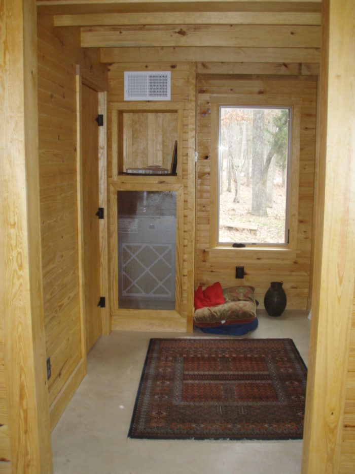

This 640-square-foot cabin with radiant floor and spray foam insulation hardly needs any cooling, but it needs dehumidification provided by the 11,700 BTU/h vertical PTHP that fits in the bottom of the display cabinet. At 10.7 SEER, its doesn't meet code minimums despite the efficiency of the envelope. A little unit like this would be perfect for a number of superinsulated situations, except it's illegal.

Designers of small, super-insulated buildings in mixed-humid and hot-humid climates may choose to prioritize right-sized equipment over high SEER equipment, largely due to the fact that advanced dehumidification is just not marketable in the smaller tonnage sizes that are appropriate for the small demand buildings. The minisplit systems that have these capabilities in small capacity sizes are very expensive and may be seen as unsightly and overly complex by many clients. (Our clients think they are ugly and hate the multi-function wireless remote thermostats).
On our very small (840-1,100 sq. ft.) buildings with radiant floor heating, we’ve been using a 10.7 EER GE ducted vertical Packaged Terminal Heat Pump (PTHP) unit (Zone-Line AZ75H12DAC for $1,454 delivered — see photo), which gives 11,700 BTU/h cooling and 3.6 pts/hr (3,960 BTU/h) dehumidification for 1,093 watts and can supplement the radiant floor heat if necessary with a 3.3 COP. The unit can be easily installed in a 24″x24″x32″ space. It’s a great, if somewhat noisy, dehumidification solution for affordable, small, very well insulated homes in a mixed-humid zone.
