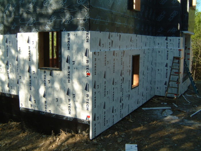

Creating an air barrier at the sheathing level and insulating on the exterior with rigid foam insulation is key to the PERSIST and REMOTE building strategies as well as Andrew Homoly's "perfect" building envelope.
Is there such a thing as a perfect building envelope? One that could be mass-produced from readily available materials, and be appropriate for 90% of all new homes?
Andrew Homoly thinks he’s found one, as he explains in this Q&A post at GreenBuildingAdvisor.
Here are the basic elements:
  • A conventional foundation insulated with 2 in. of rigid foam on the outside.
  • 2×6 walls sheathed with Zip System OSB with 2 in. of rigid foam on the outside and open-cell spray polyurethane foam in the stud bays.
  • A roof sheathed with OSB, insulated on the exterior with 2 in. of rigid foam capped with another later of OSB sheathing over furring strips.
  • Soffit and fascia made from OSB sheathing, insulated on the exterior with 2 in. of rigid foam, and topped with furring strips and finish material.
It is this last detail, the insulated and vented soffit and fascia, that has Homoly thinking he’s nailed it. He calls his approach the Homoly-Pedley Perfect Envelope, sharing the credit with his framer, Mike Pedley, who came up with the soffit/fascia detail.

    Similar walls are built in North America, but (usually) without the cross-laminated timber. It's more common here to use stick framing.
    So, the comparable North American walls would be:
    Wall #1:
    Plywood-sheathed stick-framed wall
    Larsen trusses filled with cellulose
    Fiberboard sheathing or diagonal board sheathing
    Rainscreen (vertical furring strips)
    Wall #2:
    Mineral wool panels attached to the plywood
