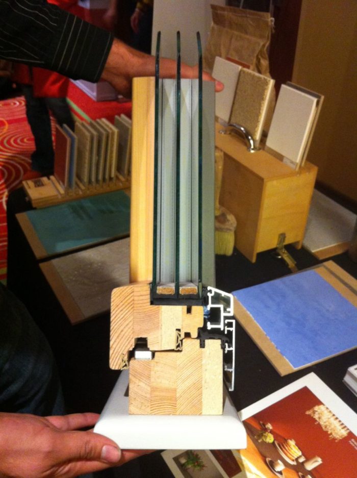

Windows. The Passivhaus standard requires that windows have a maximum U-value of 0.14, which is equivalent to an R-value of 7. (Lower U-values are better; higher R-values are better.) That’s pretty darn good … for a window.
They get to that level of performance with three panes of glass, low-e coatings, argon gas in the spaces between the panes of glass, and frames with thermal breaks. The window sample shown above is from Zola Windows, which makes some of the best windows for Passivhaus projects.
Those are all great, but again, we had triple pane, low-e windows in the ’80s. Yes, the materials and assemblies are definitely better, but is that innovation?
