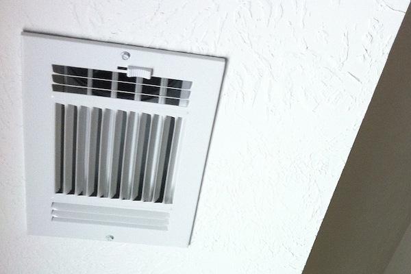

The photo on the right shows a typical supply vent for an ducted HVAC system (air conditioner, heat pump, or furnace). On the return side, you’ll typically see plain grilles, but on the supply side, where the conditioned air gets blown back into the house, most HVAC contractors install registers like the one above. It has a lever of some sort that allows you to adjust the louvers behind the grille.
You’d think that since it’s adjustable, it must be OK to open or close it to suit your needs, right?

Closed registers increase pressure
In a well-designed system, the blower moves the air against a pressure that’s no greater than the maximum specified by the manufacturer (typically 0.5 iwc). The ideal system also has low duct leakage.
The typical system, however, is far from ideal. Although most systems are rated for 0.5 iwc, the National Comfort Institute, which has measured static pressure and air flow in a lot of systems, finds the typical system to be pushing against a static pressure of about 0.8 iwc. Now we’re ready to address the question of closing registers.
When you start closing registers in unused rooms, you make the duct system more restrictive. The pressure increases, and that means an ECM blower will ramp up to keep air flow up, whereas a PSC blower will move less air. Most homes don’t have sealed ducts either, so the higher pressure in the duct system will mean more duct leakage, as shown in Image #3 below.
The more registers you close, the higher the pressure in the duct system goes. The ECM blower will use more and more energy as you do so. The PSC blower will move less conditioned air. In both cases, the duct leakage will increase further.

Nine unintended consequences of closing registers
Let me now summarize the problems I’ve described above that can result from closing registers in your home. The first thing that happens is the air pressure in the duct system increases, which may give rise to these negative consequences:
- Increased duct leakage
- Lower air flow (with PSC blowers)
- Increased energy use (with ECM blowers)
- Comfort problems because of low air flow
- Frozen air conditioner coil
- Dead compressor
- Cracked heat exchanger, with the potential for getting carbon monoxide in your home
- Increased infiltration/exfiltration due to unbalanced leakage , as I described last week
- Condensation and mold growth in winter due to lower surface temperatures in rooms with closed registers.
You’re not guaranteed to get all the problems that apply to your system, but why take the chance?
