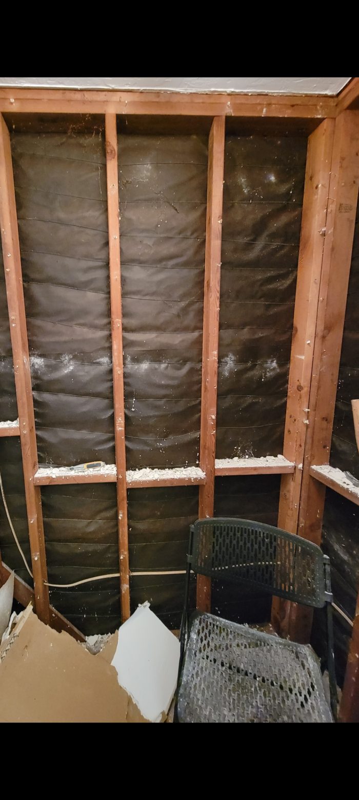

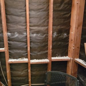

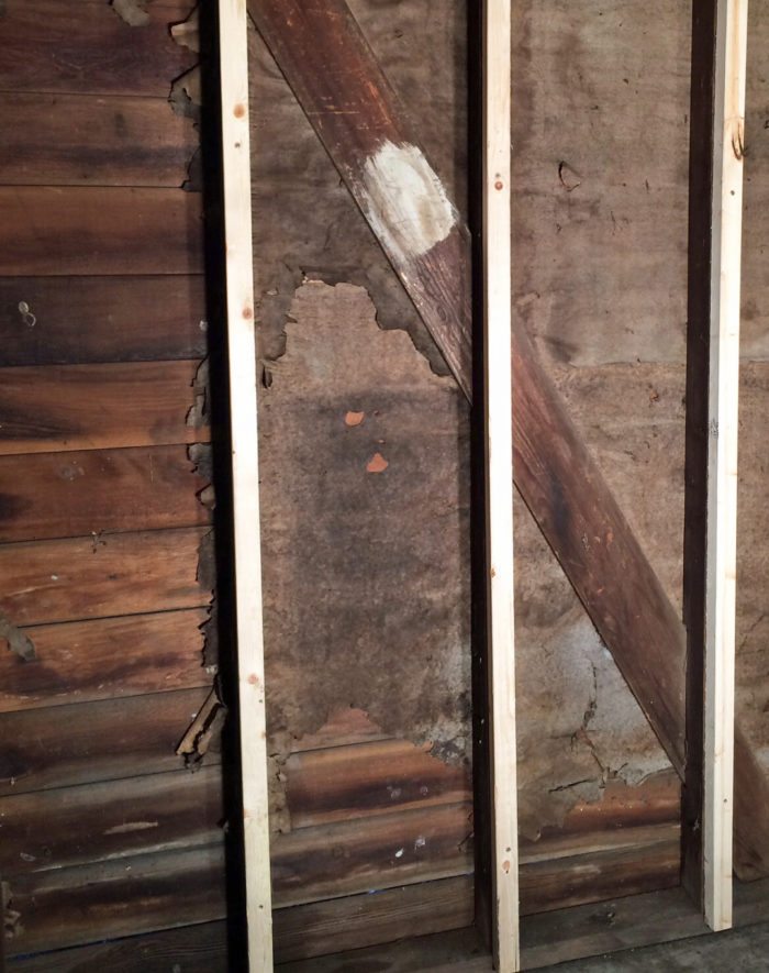

Uninsulated stud bays are common in older homes, so workers who pull down the lath and plaster expect to see the back side of sheathing boards on the exterior side of the studs. But in some cases, there isn’t any sheathing: the workers find themselves staring at the back side of the siding (see Image #1 on the right).
So how do you insulate stud bays from the inside if the building has no wall sheathing or water-resistive barrier (WRB)?

You’ve got to have an air space
There are several possible ways to insulate this type of wall. No…

So if you pull the plaster and lath off and find board sheathing behind the clapboard, is it safe to blow cellulose- up to 12" with a new stud wall built to the interior? Or would you still suggest an air gap and/or air barrier against the sheathing? I like the ventilation of the Mortairvent idea, but its expensive and isn't an air barrier.
Response to Jean Terwilliger
Jean,
That's a tricky question. It depends on the siding -- vinyl siding is safer than stucco; the climate -- warm climates are safer than cold climates; and the roof overhangs -- wide overhangs are safer than stingy overhangs.

You're correct - we have no sheathing. Our assembly from inside to outside is drywall, studs (no insulation.. yet), felt paper, and wood clapboard.

You are at risk of suffering water damage to your house.
1. You need to address the "signs of water entry, mainly under the window" by removing the window(s) and installing flashing in the window rough opening, followed by the installation of a new window (or re-installation of the existing window). You can perform a search on "flashing a window rough opening" if you don't know how to do this work.
2. It's insane to install a toilet tank in an exterior wall cavity. That wall cavity needs to be filled with insulation, not plumbing. Move the toilet. The record low temperature for Dallas, Texas, is -8°F. If you get a cold spell like that again, your toilet tank will be frozen solid.

I was confused about the sheathing, as my 1x6 pine looked a lot like the pictures. It's an old house with many repairs/additions over the years. One section of the house actually had wood siding and no sheathing, but we were able to remove it as no asbestos was present. At least 3 different scenarios on exterior walls, so far. Trying to strip back as much as we can, and do it right this time. Good to hear the suggestions for the asbestos. Your suggested upgrades are on my list.

I'm renovating a shed that has no sheathing, but does have an intact WRB of two layers of asphalt building paper between the studs and the siding, which is some kind of painted high-density fiberboard embossed to look like wood grain. The paper is very thick, heavy stuff and isn't compromised. I also live in a mixed-dry high desert climate (zone 5) with less than 7 inches of water a year so generally things that get wet dry very quickly.
In this situation, would it be safe to call the existing double-layer building paper WRB an air gap such that I could safely fill the cavities with mineral wool? I know that it doesn't qualify as an air barrier, but could the interior drywall be the wall's air barrier, so long as all the penetrations like electrical boxes were scrupulously air-sealed per the airtight drywall approach?
Nate,
Q. "In this situation, would it be safe to call the existing double-layer building paper WRB an air gap such that I could safely fill the cavities with mineral wool?"
A. Yes, I think that would be safe -- as long as the flashing details at windows, doors, and penetrations seem adequate. This is somewhat of a judgment call, so careful inspection of the house is important.
Q. "I know that it doesn't qualify as an air barrier, but could the interior drywall be the wall's air barrier, so long as all the penetrations like electrical boxes were scrupulously air-sealed per the airtight drywall approach?"
A. Yes.

I'm renovating a 1962 house in Central Texas with (mostly) no insulation.
The walls are: clapboard, felt paper (looks like double layer), studs, then drywall.
Would the felt paper be sufficient to allow the exterior to dry if I put fiberglass batts for insulation?
I understand it's not an air barrier so I'd need to do airtight drywall.
Spray foam is out of the question for this remodel, to keep costs low.
Given that we’re only adding insulation to the part of the house, is it even worth it? Or should I just rip out the old fiberglass insulation in the kitchen (only place that has it) and skip it all together?
Thanks,
Alejandro
Alejandro,
Q. "Would the felt paper be sufficient to allow the exterior to dry if I put fiberglass batts for insulation?"
A. Yes.
Q. "Given that we’re only adding insulation to the part of the house, is it even worth it?"
A. Yes.
Q. "Or should I just rip out the old fiberglass insulation in the kitchen (only place that has it) and skip it all together?"
A. No.

There are also some places where the tar paper is compromised, but fortunately not a lot.
My GC wanted to add "housewrap" between the studs in these cases (bathroom mostly) then add fiberglass batts. Should we just stick to felt paper? This area (bathroom) seems to have moisture issues in the past (probably due to improper window flashing, compromised WRB).
Alejandro,
The best thing to do is to follow the advice in this article.
Since you don't want to do that, you'll have (as you say) a suboptimal situation.
If you have areas that have had "moisture issues in the past," any advice from internet sources (including me) would be suspect. The only way to analyze and fix that type of moisture issue is with a on-site inspection.
Good luck.
Martin,
Really appreciate your thoughts so far. I'm thinking I'll try the rigid foam approach.
Just one question, given the double layer tar paper, do I need the spacers to leave a gap behind the siding? I noticed the way the tar paper sits, it already forces a bit of an airgap.
Just trying to cut as much labor of this as possible...
Best,
Alejandro
Alejandro,
Research suggests that two layers of asphalt felt, conscientiously installed, can indeed provide a small air gap that is adequate for drainage. One key aspect of this discussion is ascertaining whether or not the asphalt felt on your walls was consistently installed (with two layers, properly lapped, in all locations).
If you think that the asphalt felt is doubled everywhere, and is in good shape, you may (to limit the amount of fussy labor) want to omit the air gap between the insulation and the sheathing.
It's essential, though, that you determine the source of the moisture that caused the "moisture issues" you mentioned.

Martin: against my better judgement during this pandemic, I did the crazy. I’m in the process of stripping the walls on two of the bedrooms down to the stud in my 120 year old house. What I’ve noticed about the makeup is the following.
The stucco was laid on top of building paper, followed by wood boards, no insulation in the bays, followed by lath and plaster. The building paper looks ok. Seems to be great in most spots except for the corner where it’s degrading.
Based on that do I need to put in an air barrier?
Thanks,
Leo
Leo,
Every exterior wall needs an air barrier. Board sheathing is not an air barrier; nor is kraft paper. Stucco is sometimes a "fair to middling" air barrier, but stucco cracks and penetrations reduce the effectiveness of stucco as an air barrier.
I would certainly strive for airtightness if I were you -- the Airtight Drywall Approach is one possible way to proceed.
Note that your wall lacks a decent water-resistive barrier (WRB), and it also lacks a rainscreen gap. Whether or not these issues will matter depends on your climate (especially your expected annual rainfall) and the width of your roof overhangs.
My roof overhang isn't much. It's a dutch colonial style roof. Also I live outside Philly zone 4A.
So I need some advice on the best path forward. What should I consider from a cost benefit stand point; foam board + insulation or felt paper + spray foam. Labor might be more that spray foam.
Leonard,
These decisions aren't really cost/benefit decisions -- at least if you are thinking about energy costs. For a house without a WRB or a rainscreen gap, the risk is water entry and rot. One clue to help you make your decision is to look carefully at your sheathing boards for evidence of water entry (discoloration, mold, perhaps rot), especially near the bottoms of your windows.
If there is no evidence of water entry, that's good. That said, insulating your walls will reduce the walls' drying ability, raising the risk of future problems.
Ideally, you would strip the stucco and install a WRB, rainscreen strapping, and new siding. But that's expensive. Good luck with your decision.

I'm trying to determine if this approach is applicable to my 1920s house in climate zone 5, but I am not entirely sure of some of the building materials. I'm certain the exterior has cedar shake shingles, and I've attached a photo of the stripped studs of an exterior wall. Is the horizontal lumber against the studs considered sheathing?
I'm unsure if there is tar paper or any kind of WRB in between the horizontal lumber and cedar siding (there is definitely no rigid foam on the exterior).
I removed lathe and plaster as well as cellulose that had been blown in from the exterior by a previous owner. There appears to be no signs of water damage in the cavity of the wall. I am planning to use rockwool r-15 batts and will not use a vapor barrier, but I'm wondering if the air-gap approach is one I should take.
Thank you and happy holidays/Holladays,
Tyler
Tyler,
Yes, your house has sheathing. The fact that there are no signs of water damage is good news.
To determine whether your walls have a water-resistive barrier (perhaps asphalt felt) or some type of paper like rosin paper, you can either investigate from the interior by looking at a wide gap between sheathing boards (using a flashlight, and widening the gap carefully with a knife if necessary) or from the exterior, by removing a few shingles from the bottom of your wall in an inconspicuous place.
An air gap between the sheathing and the rock wool batts is not necessary. If you ever install new siding, however, you might want to install a water-resistant barrier (WRB), depending on what your investigations find.
