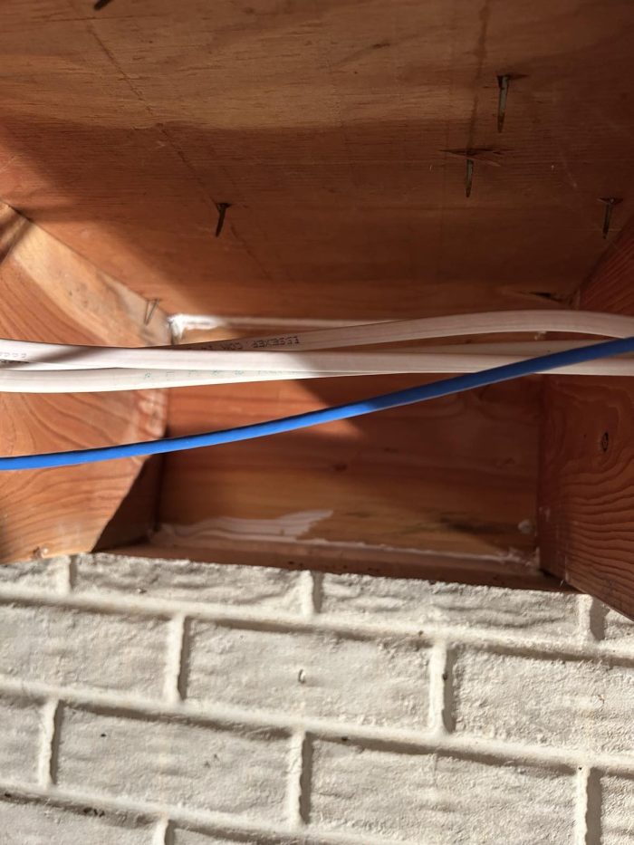

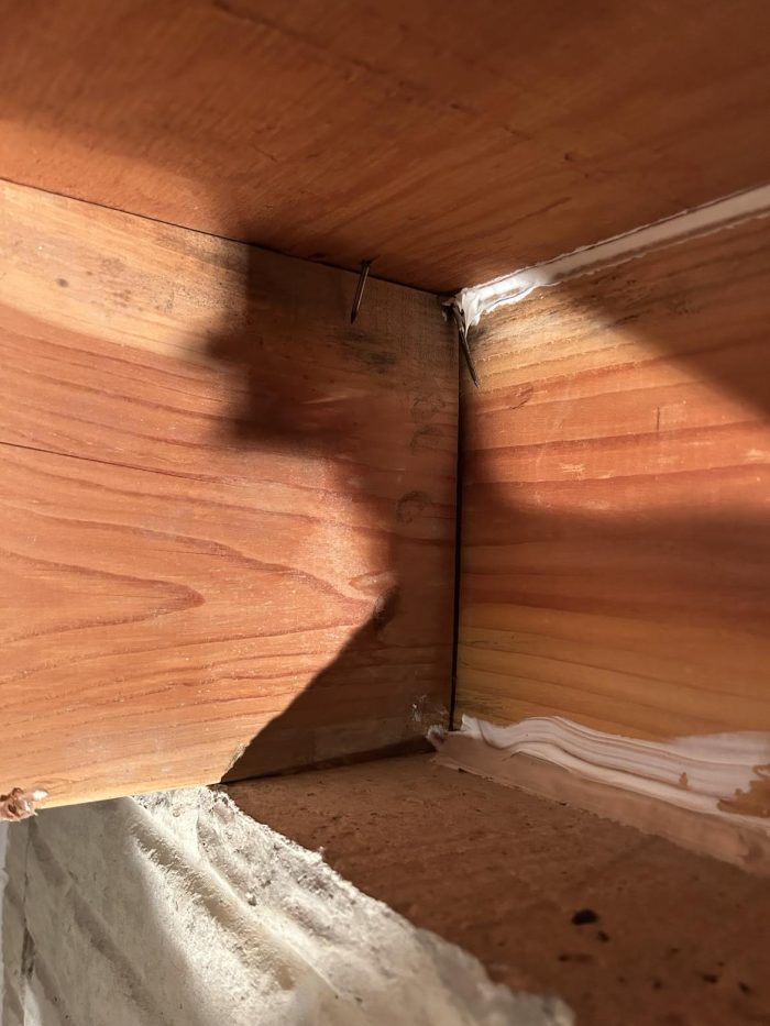

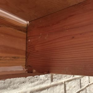

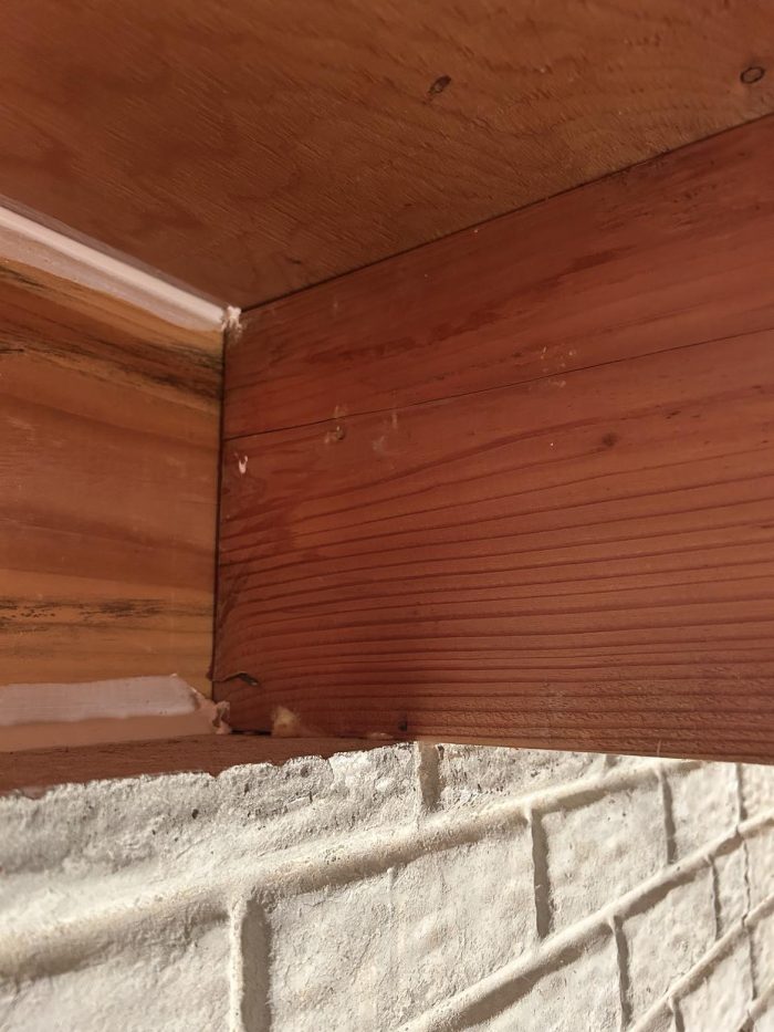

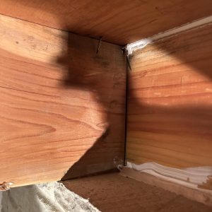

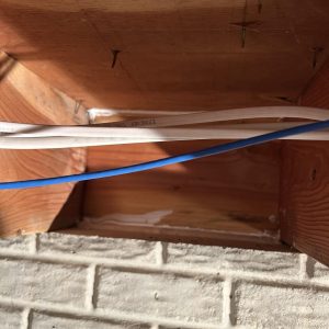

In my case, I already have 2" of closed cell spray foam in the joists. Is it ok to fill the rest with open cell? Is there a risk that the open cell just acts as a sponge?
While I support using the the right technology for the job, I am cautious about adding yet another insulating technology to the mix.
Hot/humid climate 3a (South Carolina)..crawlspace w/moisture barrier, unfinished 2nd floor (plan to finish 1450sqft), & it’s a modular home. I’m sorry to beat a dead horse. I would like to know if spray foaming the perimeter of a rim/band joist would be as advantageous from an air sealing perspective as insulating the entire area(s) of each rim joist w/spray/rigid foam. Why not just do the perimeter(s)? How does air pass through wood if it has no cracks to pass through? Thank you for the articles and comments—I am learning a lot here.
Also, would it be wise to insulate the married sections of the modular joists in a similar fashion (I’ve foamed the crack between the married joists at the bottom).
K. Dodson,
If all you are doing is air sealing, focus on the cracks. But if you care about R-value, you need to have a layer of insulation that covers the entire rim joist. In South Carolina, the building code requires above-grade walls to be insulated to at least R-13 -- so that's a good minimum target for the R-value of your rim joist insulation.
Martin,
Thank you for the reply. I got some reclaimed rigid foam that is used for roofing. It is not foil faced, but rather a polyiso with a fibrous dark colored covering. It is used for roofs. (R-Max MultiMax FA-G3) 2.5” R15.
I’ve read a lot of your articles’ comments about covering with drywall afterward.
I sincerely appreciate your time. I have so many questions.
Also sir, I was concerned about the exterior of said rim joist as well. I have crawled the crawlspace a lot now and I’ve done my best to air seal electrical/plumbing/HVAC register penetrations.
The exterior cladding is vinyl siding and at the very bottom of the siding, I can see the mud sill connected to the brick crawl foundation. Can a product be used to successfully close that gap? I’ve read about gaskets but this is existing construction. Could tape or a form of caulking work there?
I guess I’m confused for several reasons, but I feel air sealing needs to occur both interior AND exterior for it to be effective. I would think air/water could run through the mud sill seam and even though it’s foamed from the inside, air would still be able to travel up. Am I off in my thinking?
K. Dodson,
Q. "The exterior cladding is vinyl siding and at the very bottom of the siding, I can see the mud sill connected to the brick crawl foundation. Can a product be used to successfully close that gap?"
A. Any gap between the mudsill and the foundation can be sealed with a high-quality caulk. Note, however, that you don't want to caulk the gap between the vinyl siding and the mudsill. That gap should be allowed to drain.
Q. "I feel air sealing needs to occur both interior AND exterior for it to be effective. I would think air/water could run through the mud sill seam and even though it’s foamed from the inside, air would still be able to travel up. Am I off in my thinking?"
A. In theory, all you need is one air barrier. If all you have is an interior air barrier, and the air barrier is perfect, your air sealing work is done. That said, perfection is rare, and many builders prefer the approach you suggest -- sealing envelope leaks on both sides. For more information on this topic, see this article: "One Air Barrier or Two?"
Your concerns about water entry are a little different from your concerns about air sealing. It's always a good idea to prevent water entry, but the usual way to prevent water entry is to use flashing -- and flashing doesn't have to be airtight. It just has to prevent water entry. For more information on flashing, see "All About Flashing."
The normal way to prevent water entry at the gap you're talking about (the gap between the mudsill and the foundation) is with your water-resistive barrier (usually asphalt felt or housewrap). Hopefully, your house has a water-resistive barrier. If it doesn't, your house isn't up to modern standards -- but it may still be OK, especially if the house has adequate roof overhangs. For more information on WRBs, see "All About Water-Resistive Barriers."

Martin, I hope the following more clearly describes our walk-in basement walls. Our house is built on a hill. In this walk-in basement the mostly below-grade exterior wall abuts the hill. The adjoining exterior wall is above-grade. We are in climate zone 5. See photos posted below and in next post, where I will post temperature readings, too.
Please suggest a plan to insulate these 2 walls. Short of replacing the drywall, if I only add rigid foam blocks to the joists above the above-grade wall, is it safe to cover the gap?
The joists in the below-grade wall are too deep to insulate with rigid foam board and would have to be filled with close-cell spray foam. In this area, if we blow in foam should we cover the air gaps?
What would you recommend we do if we replace the dry wall?
Thank you.
Here are answers to your questions:
1. These walls appear to be totally uninsulated. Short of removing sections of drywall I can't definitively know.
2. Re air gaps, in the above-grade wall IF there is a gap on the interior side of the brick and mortar wall it is covered by a horizontal plate and can't be seen. I suspect there is gap because there is such a gap in the adjoining mostly below-grade wall.
In the below-grade wall there is a gap between the interior side of the brick & mortar wall and the concrete block wall as well as a gap between the concrete block wall and dry wall (see pic).
3. I cannot see or feel a water-resistive barrier (like asphalt felt or housewrap) between the brick & mortar air gap and the plywood sheathing.
4. The 1/2 inch furring is vertical.
5. Re the poly barrier - we are in zone 5 (Indianapolis)
6.. The ceiling joists extend beyond the mostly below-grade wall approximately 3 feet. see interior and exterior pics
7. The 1st 3 photos below are of the above-grade wall. The next 2 are of the mostly below-grade wall. The following post includes 2 more below-grade wall assembly photos and temperature readings of each wall inside the basement and from within each wall assembly. The last photo is an exterior view of the gray enclosure built around the last 3 feet of rim joist area.
Below are 2 more photos of the below-grade wall assembly and temperature readings of each wall inside the basement and from within each wall assembly. The last photo is an exterior view of the gray enclosure built around the last 3 feet of rim joist area. This gray box is directly below the 1 3ft of the kitchen floor; which, you can imagine, is always v cold in the winter.

Randy,
It sounds like your joists are cantilevered over your foundation. It also sounds as if the cantilever is uninsulated, and your above-grade wall is also uninsulated.
Whether to insulate these areas is up to you. You'll probably need to do some demolition to insulate everything properly. I suggest removing the soffit under the cantilever so that you can access the cantilevered joist area. (Alternatively, you could fill the cantilevered joist area with spray foam, working from the basement.)
To insulate your walls, you'll probably need to remove the drywall in order to add a layer of thick rigid foam to the walls. Alternatively, you could add rigid foam to the interior side of the existing drywall, followed by a new layer of drywall.
