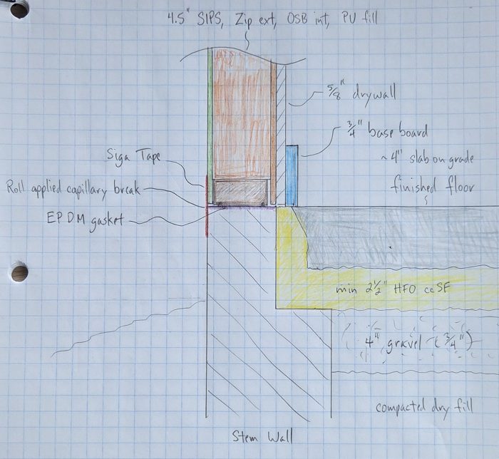

      Older thread but I’d like to see if anyone has opinions on this option is relation to maintaining a good waterproof layer below the slab. We are about to build a full basement house in Victoria and my main concern is proper detailing to maintain a dry basement. Robust Perimeter drains, good waterproofing on the foundation walls with dimple mat and exterior sump pumps. Just don’t want to detail a basement that will have issues. Cost is second to a dry basement for the life of the building.
      Thanks for any input!
      1. Malcolm_Taylor | | #21
        Onesmallstep,
        To me the most important sub-slab elements to include for water management are a layer of freely draining gravel to act as a capillary break, and a good vapour-barrier. I don't think much rides on what type of insulation you use.
  8. onesmallstep | | #22
    Thanks Malcolm,
    Personal build in a wet climate, full basement with 10’ of clay the whole way and no gravity drain parameter drains, pumped up to city, so I’m leaning on the paranoid side of detailing the basement. 😬 I totally agree with you and likely just over thinking it. We will get a good clear crush layer all around. I guess I just wonder how the Closed Cell spray foam will act as a Vapour Barrier below the slab over many years in relation to water ingress management. Ie shrinkage and potential separation at places. Have opened up “older” homes with spray foam and have seen it separated from framing in places.
  9. Malcolm_Taylor | | #23
    onesmallstep,
    In terms of vapour driven moisture, I think you are all set with the capillary break, and poly. If you get water building up under the slab, I'm not sure there is much that can resist the hydraulic pressure.
    I'm typically an anti-basement guy, due to having seen how many experience flooding at some point. But having said that, considering our wet climate on the South Island, basements generally do relatively well here for some reason.
