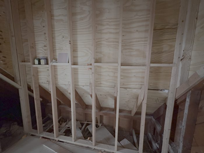

Does anyone have details on building the subfloor for the "devil's triangle"? The issue is that that area is not only awkward with trusses intersecting the floor, but the lumber in that portion isn't the same size as the rest of the truss. Is the best approach to sister the trusses with the same sized lumber as the rest of the trusses, add blocking to form a rectangle for each bay, and then cutout one panel per bay with notches around the trusses? Or would it be better to run long lengths of lumber on top in the opposite direction so that the cumulative height matches the rest of the floor? This also seems difficult to air seal well, which is important to separate the garage below.
I've got a knee wall situation in which I have attic trusses with 2 x 12s until the knee wall where the truss drops down to a 2 x 4. Technically that 2 x 4 area in the devil's triangle isn't deep enough for the R38 insulation. But one Contractor told me he'd just "twine" them to hold them in place. On the other hand we planned on un-faced batts with a 4 mil VB. Can't figure out how we're supposed to run 4 mil in that area? Is there an acceptable way to run those R38s all the way down without a bunch of extra framing? Or another solution? I don't want to insulate the knee wall.
