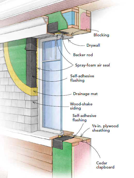

Builders installing thick exterior wall foam can install windows two ways: with the window flanges in the same plane as the back of the siding — so called “outie” windows — or with the window flanges in the same plane as the OSB wall sheathing — so-called “innie” windows. Either way will work.
Let’s consider a wall with 2×4 studs, OSB sheathing, 4 inches of exterior foam, 3/4-in.-thick vertical strapping, and fiber-cement lap siding. How should the windows be installed?
Outies, step by step
A builder who prefers “outie” windows would do it this way:

    Each of the systems that you described included a box of plywood or a box of costly trim.
    In the case of the Innie...The "box" provides a thermal shortcut from inside to outside.
    The Innie Strategy adds more exterior surface area(heat transfer) to the system.
    The Outie looks like a warmer/safer(in winter) assembly to me.
    The Outie will have less exterior trim material to maintain.
    The head detail for Innies seems very complex to me.
    Outie requires less of the costly flashing materials.

    The Outie works with 2 dimensional flashing.. the Innie is 3 dimensional.
    The Innie creates 8 additional "triple points"(3-d corners)
    It is hard enough to get the 2-D stuff right.

    innie has better energy performance in cold climates
    Although it may seem like the innie adds exterior surface area and provides a thermal shortcut between inside and outside and therefor has worse performance than the outie, I believe this is actually a simplification. Because the window frame is a very week link in the thermal envelope, you have to look at how the placement affects the interior surface temperature of the window frame. Placing the window at the very exterior plane of wall will greatly lower the interior surface temperature of the frame, which can lead to condensation, especially if it is a typical wood (uninsulated) frame in a cold climate. Placing the window in the middle of the wall cavity, in general, will result in a warmer interior surface temp in winter. The Passive House method is the best from an energy perspective: place the window in the middle and cover the outside of the frame with insulation. This is possible because window manufacturers in Germany design windows to be insulated, and also because european windows open towards the inside.

    The latest issue of the Journal of Light Construction has an article by Fairbanks, Alaska builder Thorsten Chlupp, who strongly prefers innie windows over outies.
    He writes that he prefers innies "because the window is somewhat protected from wind-washing and the interior glass is more easily warmed by the heat in the room. ... I've observed that in extremely cold weather — when it's 25°F below zero, for example — frost tends to form inside windows installed at the face of the wall, whereas frost rarely occurs on inset windows. I've installed windows both ways, but because of the frost problem I now do only recessed installations."

    The position of windows within a deep wall affects the thermal performance of the wall itself. The inside of the window is at room temperature and the outside is at ambient. So the temperature gradient through the window is steep. The temperature gradient through the wall is more gradual since the wall is thicker than the window. If a plot is made that shows lines of equal temperature (isotherms) within the window and the wall than these lines are parallel to both the surface of the wall and the surface of the window. The lines are closely spaced within the thickness of the window and more widely spread within the wall.
    The transition zone (from the edge of the window to some distance away from the edge) where the lines change spacing is interesting. Around the window cills (external, internal or both) there are parts of the thickness of the wall which are at ambient or room temperature. In the transition zone, from a purely thermal pont of view, the effective thickness of the wall increases from the thickness of the window to the overall thickness of the wall. Obviously, if the wall is not as thick then its thermal performance is not as good. So the thermal performance of the wall is degraded in the transition zone.
    When the temperature distributions are modelled and plotted, the transition zone appears to be approximately as wide as the cill is deep – the isotherms nearest the surface have a slope of ~1:1. With an outie window all the transition is on the inside; with an innie window all the transition is on the outside. So the transition zone, the zone of degraded thermal performance, is about as broad as the thickness of the wall minus the thickness of the window. If the window is placed in the middle of the wall then the transition takes place in both the inside and the outside of the wall. The transition zone is then about as broad as half the wall thickness minus half the window thickness. So the thermal performance of the wall is degraded less than with either an innie or an outie.
    The area of the transition zone is proportional to the perimeter of the window – another good reason to size windows carefully to balance solar gain and conductive heat loss. Two windows which are sufficiently close that the transition zones that they would have in isolation overlap will cause an even greater loss in performance in the wall that separates them. It would be better to have them side-by-side or, better still, combined.

    Although I'm convinced that innie windows perform better, I continue to prefer outie windows. In addition to the point you made, here's why: to me, outie windows look better; I worry about the integrity of the flashing details with innie windows; and I like to have wide interior window stools.
