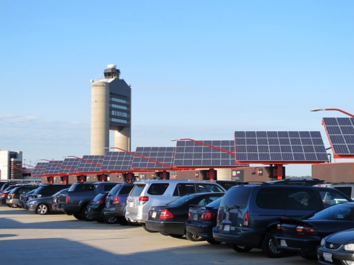

If we do it right, hopefully skeptics will embrace big solar
What makes me hopeful is that solar arrays can be beautifully integrated into architecture, and can even provide added value in the form of shade structures or carports. I truly wonder why the idea of covering parking lots with solar arrays hasn't caught on. It seems like a no-brainer, or maybe I'm missing something.

Solar parking lots and PV fed electric car charging station/parking is beginning to show up in CA, particularly in areas where electric cars are being promoted heavily by local municipalities. But even in less-sunny (but solar-subsidized) MA there are existence proofs of the suburban PV-parking lot concept:
http://www.rei.com/share/rei-blog/2012/08/from_asphalt_to_elec.html
