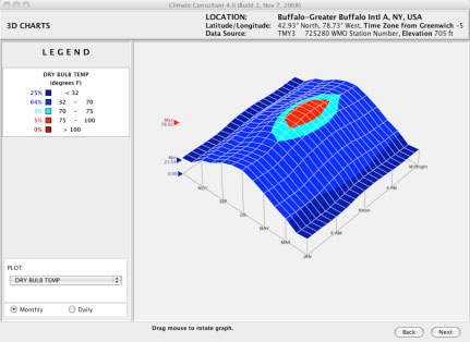

When I teach the Building Envelope course for the Boston Architectural College’s on-line Sustainable Design Certificate program, I always seem to be stringing together a bunch of different web sites for nationwide climate and weather data. But then I came across the free software, Climate Consultant 4 (CC4)1. It’s an amazing tool. It takes all that weather data and serves it up in 17 different charts, all of which are clear and compelling visual expressions of the data. Here are some of my favorites.
3-D Charts
Note how the colors categorize ranges of air temperature and how you can use the mouse to rotate the image to think the pattern through from different angles. It’s pretty easy to get a sense of temperature patterns with the data expressed in this 3-D chart.
The drop down menu under “Plot” allows you to use the 3-D chart for seven other weather parameters, like relative humidity and wind speed.
