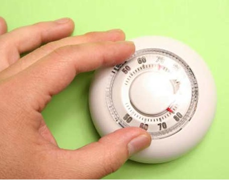

I think Steve Mouzon stated the comfort/energy situation best in this excerpt from his new book, “The Original Green”: “Our ancestors had a comfort range of probably 30 degrees Fahrenheit.” We are physically capable of reasonable comfort between roughly 60 and 90 degrees Fahrenheit. Yeah, 60 is kind of cold, but you can dress warmly; and 90 is kind of hot, especially in humid climates, but you can dress lightly and use fans and manage. However, few people are willing to do this. In most climates, windows are closed and HVAC equipment runs much of the year, often when the outdoor temperature is perfectly moderate.
So, why don’t people just turn off their HVAC and open windows more often? I see it as a two-part problem. First, in most places, energy costs are too low (my apologies to those who heat with fuel oil). Second, and more important, it takes effort. Most people lead very busy lives, working long days away from home, so it’s difficult to make the frequent changes needed to manage their energy use better.
I have the luxury of working at home, which allows me to monitor indoor and outdoor temperatures and humidity throughout the day. Whenever the temperature outside is close to a comfortable level, my windows and doors are open. This summer, I only use air conditioning when the outside temperature climbs over 82 (or if I have guests in the house), allowing me to open the house almost every evening until about mid-morning, when I close everything up. I keep the AC set at about 84, use fans judiciously, and dress for the weather (you don’t want to see what I’m wearing as I write this). My house isn’t perfectly comfortable, but it is bearable most of the time. I am willing to live with some slight discomfort to cut down on my power use, and I am here to manually manage ventilation as needed during the day.
Our long-term challenge is twofold: How do we encourage people to learn to widen their comfort range, and provide them with the tools, the time, and the wherewithal to manage their homes to use less energy on a daily basis?

Stop and Go ... Cruising and Latent Loads
Carl,
Maybe your strategy makes sense in a poor performing Home.
I wonder how much Energy you would really save with a Good Enclosure.
A seminar that I attended (sponsored by Austin Energy) seemed to question your strategy.
You need to consider the hygrothermal storage of your structure and contents (furniture & stuff).
You are charging your house and contents with heat and moisture that you will have to remove later.
Austin Energy seemed to suggest that the Latent Load could be significant.
I wonder what Michael Blasnik thinks?
My guess is that in a good enclosure it would cost very little extra to be comfortable.
