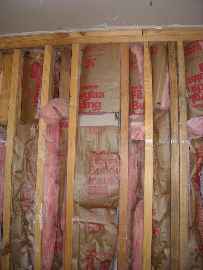

Michael, isn't it true that only perfect installation of batt insulation will create the expected (labeled) R value? By perfect I mean zero compression is allowed for the batt, which is simply impossible. Would you say that some of the benefits of full-fill insulation (spray foam, cellulose) are actually true R value and also the air infiltration benefits?
In the picture it shows a typical installation of batt insulation. Would you say that any of these wall spaces have the actual R Value that the product tested out at in the hot box test?

Yeah, you nailed it Steve. Let me answer one at a time. Yes, only the perfect installation (assuming all other components of the assembly were installed and operating correctly) will ensure the stated R-Value. Yes, spray foam and cellulose do a better job of realizing the stated R-Value but the former does a better job of reducing/eliminating/managing air infiltration.
The photo is of course an attempt at humor and I would hope not typical even for batts! But most assuredly the wall is not getting anywhere close to R-ll because there is too much wood and not enough insulation and because the insulation that is in the wall is insufficient and improperly installed.
