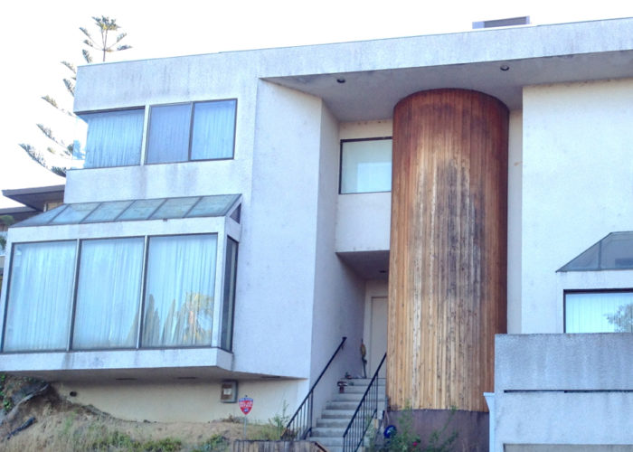

Is a flat roof the problem? An Atlanta architect is looking for the best way to insulate the flat roofs he often includes in his designs for contemporary houses. Although this photo doesn't depict the house in question, it illustrates some of the challenges faced by flat-roofed buildings.
