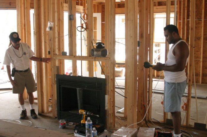

Imagine you’re in another country where no one speaks English, and you just want to find your way to the hotel. How do you communicate? Carefully, right? You’ll have a similar problem if you are a first-time homebuilder communicating with a building inspector…especially about green products or materials.
Communication is key
The first thing you have to do is to learn the basics. Good communication depends on a common understanding of the terms and procedures. An inspector will be more accustomed to working with a production builder, who generally uses conventional materials. A green home will be a curveball for the inspector, so the responsibility for successfully communicating your plans will fall on you.
You communicate with an inspector in the same way as you do with anyone else; with courtesy and respect but always by trying to listen. The inspector understands construction and is mandated to ensure safety. Most inspectors have construction experience, and a few will completely understand your world, but some will need some tutoring on green building practices. So, start by explaining the principles of sustainable building and green building practices. Then, segue into how this relates to the building code. It does so in many ways:
