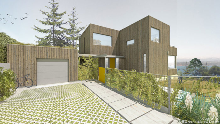

This is the fourth and last post delving into the anatomy of high-performance wall assemblies, beginning with the Karuna House in Oregon. This week’s post explains our approach at the Madrona Passive House.
The wall assembly at Madrona Passive House shows how Hammer & Hand’s approach to high-performance envelope construction is evolving. With each project we are working to simplify assembly and hew as closely as possible to standard construction techniques. This is good for our installers in the field and for project budgets. The wall at Madrona Passive House takes advantage of the compressive strength of mineral wool to suspend the home’s exterior insulation with the rain screen battens’ fasteners.

Does anyone anything about the pavers in that photo? It looks like they let grass grow through.
Grasscrete
One brand of such pavers:
http://www.grasscrete.com/index.html
I'm all for permeable pavement, but I'm not sure I want a driveway that needs to be mowed.

Hammer and hand thoughtfully and meticulously detail their projects, but I don't understand why the basic form of the houses doesn't better reflect the climate they are being built for. Flat roofs with no overhangs in the PNW mean the walls have to do the heavy lifting. I know the owners probably favour a modernist aesthetic, but starting from those forms means you are fighting the climate from the get-go.

I agree! Every House Needs Roof Overhangs.

Agreed, we prefer overhangs, too. But as a builder we are often called upon to execute projects without them. Also, it’s worth noting that there are tons of commercial buildings in the Pacific NW that are built with no overhangs and with flat roofs. Everything from zoning to aesthetic considerations mean that no-overhang design continues. Our approach as a builder is this: with high exposure must come careful detailing.

I have no doubt the houses you build will perform very well, overhangs or not. But an apt analogy might be how well any old sweater looks on a beautiful model. Seeing these projects might make prospective builders choose similar forms, when they would be better served by picking a more forgiving design.
