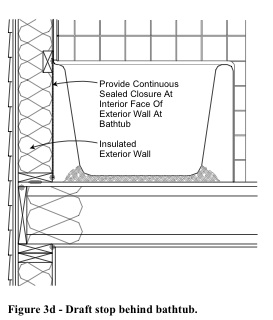

To get the water, air, and thermal barrier continuous and aligned around the tub, several trade contractors have to integrate their work, honoring the trades that come before and after their work. That's where high performance scopes of work come in mighty handy.

Scopes of work (SOW) are part of the legal contract between the general contractor or client and the trade contractors, detailing exactly what must be done to complete his or her work and achieve the desired result, an assembly or system that works. A program of SOW connects the work of individual trades so that the work of each produces the desired result: a home that works.

These four elements are used to lock in trade contractor performance, most importantly, creating hard links between what conditions one contractor needs to start his or her work (pre-work checklist) and the conditions that must be achieved in order for the next trade contractor to do his or her work (post-work checklist).

That essentially meant adding building science and systems-thinking to each of the four elements of Davenport’s SOW program for these trades. The new high-performance pre- and post-checklists integrate these six trade contractors’ work; whenever possible, we added performance testing for the desired result (for example, linking blower-door test results to the air sealing and insulation contractor’s final payment). As you look over the IBACOS High Performance SOW you will see construction details strikingly similar to ones within GBA; the same architect, Steve Baczek, did the details for both.
