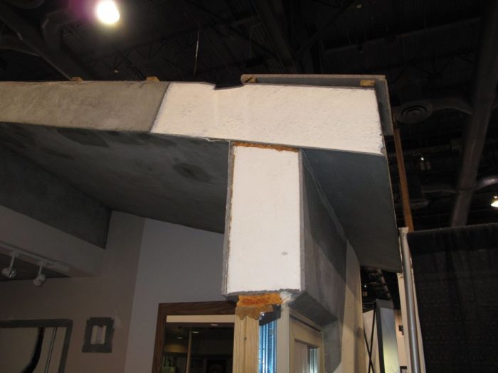

Vegas is a strange town indeed for anyone interested in green building, but here I am at the International Builders’ Show, an annual convention on a gargantuan scale.
On my first afternoon, I had time for only a quick tour of a small portion of the trade show floor, but I still spotted some interesting products. The first booth to catch my eye belonged to Strata International Group of Glendale, AZ (www.strataus.com). Strata has developed a building system using expanded polystyrene (EPS) foam for walls and roofs. Custom-cut foam panels are assembled into the shape of a building, and then both sides of the foam are sprayed with a fiberglass-reinforced cementitious coating. Once the thin concrete layers are cured, the walls and roof become a monolithic mass, resembling a SIP structure in cross-section, but without the OSB, and without the seams. It looks like an excellent way to build a well insulated airtight home without thermal breaks.
