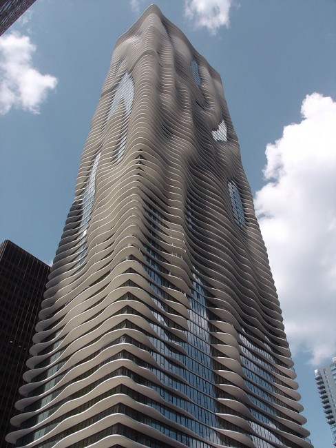

Thermal bridges
Thermal bridges are a major avenue for heat loss in a building envelope. They occur when material crosses through the building envelope, creating a direct link between the heated interior and the cold outdoors and allowing heat to escape the building envelope. A classic thermal bridge is the shared concrete slab underneath a house and its attached patio; heat from inside the house travels outside through the concrete slab, and the furnace has to work harder to replace all the lost heat. You’re basically paying to heat the outdoors. The reverse happens during the summer, when outdoor heat travels through the concrete into the air-conditioned house.
There are numerous ways to “break” a thermal bridge without losing the structural benefits of a shared platform, but many builders don’t bother. Aqua Tower, a gorgeous new high-rise in Chicago, should have been built with special thermal breaks for cantilevered balconies, but the builders skipped that crucial step. The building is structurally sound, of course, but it’s not nearly as efficient as it should have been.
I suppose I’ve already given away the punch line, but here’s the next haiku:
Undulating waves
Gently caressing the sky
Massive thermal bridge.
