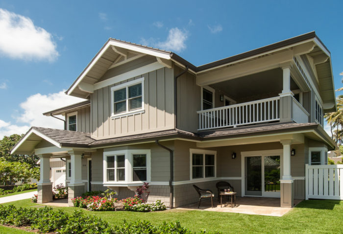

The U.S. Green Building Council has selected a 3,400-square-foot house in Kailua, Hawaii, as its outstanding single-family LEED home of the year.
The LEED Gold house is the first in the state to be certified under the latest version of the LEED for Homes program, and one of the earliest certified houses in the country, according to its builder, Mokulua High Performance Builder. It’s also one of the first in the state to be certified under Energy Star version 3, Mokulua founder Michael Fairall said.
An important construction detail is a top-to-bottom radiant barrier, the company said, including the use of DuPont’s Tyvek ThermaWrap LE on exterior walls and TechShield radiant barrier sheathing, manufactured by Louisiana Pacific, on the roof.
“The house was conventionally wood-framed with R-13 fiberglass batt at the walls and R-30 fiberglass [batts] in the ceilings,” Fairall said in an email. The exterior of the two-story house is a mix of fiber cement products, including board-and-batten panels and shakes.
“In all of our homes we implement a natural/passive ventilation strategy, which consists of solar attic fans, continuous running (low sone) exhaust fans (in garage and guest bath) as well as humidistat controlled exhaust fans,” Fairall added.
Domestic hot water is supplied by a solar thermal system, and the house also has a 4.5-kW photovoltaic array. Although small for the size house it is powering, Fairall said the PV system should be enough to meet the home’s energy requirements on an annual basis.

Radiant barriers must be installed correctly in order to be effective. Without an air gap, a radiant barrier won’t work. In the wall assembly described by Fairall, structural sheathing is installed over wood framing, followed by 3/4-inch-thick battens, then the ThermaWrap, and siding. In the roof, the radiant-barrier sheathing is applied on top of the trusses with the batt insulation installed at ceiling level.
The house meets insulation requirements of the 2012 International Energy Conservation Code for Climate Zone 1 (R-13 in the walls and R-30 in the attic), but is by no means heavily insulated.
“Since Hawaii is a temperate climate, we don’t have to worry about heating and rarely require cooling on a large scale (central air),” Fairall said by email. “More typically, we use passive cooling through a mix of natural cooling and exhausting with whole house fans / solar attic fans.
“UV radiation causes heat build-up and can contribute to material degradation, especially with certain composite products, hence the reason composite roof shingles, vinyl siding and other similar products shouldn’t be (and for the most part are not) used in Hawaii,” he continued. “As such we use products and coatings that not only can stand up to the harsh climate but can also reflect or prevent radiant heat transfer.”
The 3,460-square-foot house, with four bedrooms and 3 1/2 baths, was completed in 2014 at a cost of $795,000. The house was built on the site of an existing home, but the designer on the project, Archipeligo Hawaii, said a number of parts and pieces, such as old window glass and some flooring, were reused in the new one.

What saddens me about this project is that with its subdivision craftsman style it looks like what we see everywhere from Calgary to San Diego. There have been no modifications for the local climate beyond incorporating a few energy efficient materials into the building envelope. If that's what Leed champions as a great house for Hawaii, count me out.
