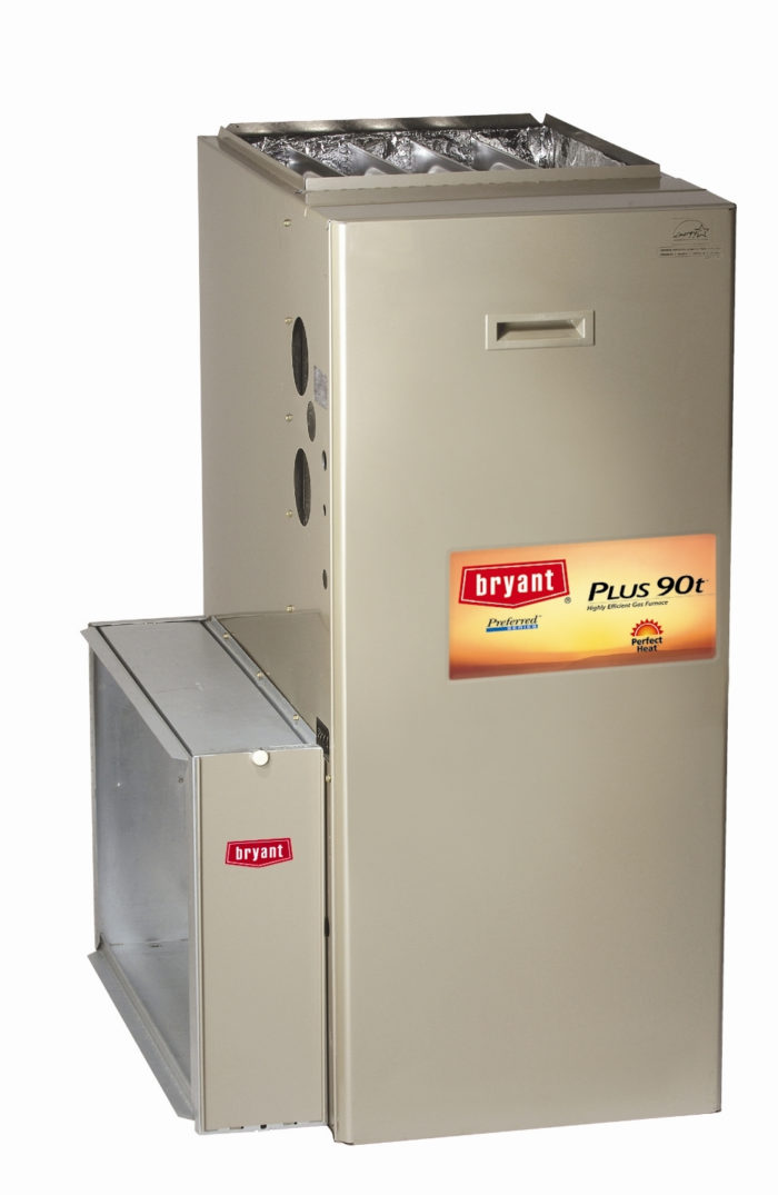

New efficiency standards for fans installed on forced-air furnaces will reduce power consumption by as much as 46% and save U.S. consumers more than $9 billion on power bills through 2030, the Department of Energy says.
The department announced the new rules on June 25, saying they were part of the federal Climate Action Plan and were the latest of eight final and nine proposed standards issued since last year.
More efficient fans, which will be required beginning in 2019, will reduce carbon emissions by as much as 34 million metric tons through 2030, the DOE said.
The specifics of the rule are spelled out in a lengthy document that lists requirements for different types of furnaces. Each type must meet a certain Fan Energy Rating, which is the amount of electricity needed to move a cubic foot of air per minute (watts/cfm).
Savings in electricity ranged from 46% for several types of gas furnace to as little as 12% for non-condensing oil furnaces and certain furnaces for mobile homes.
