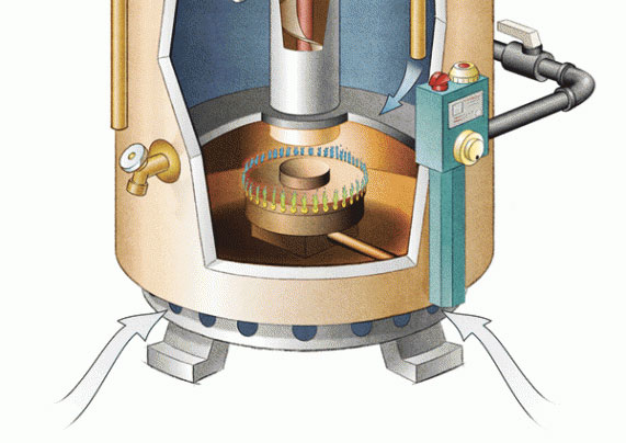

I was asked to write this blog about naturally aspirated fossil-fuel water heaters in green retrofits as a response to a rather heated debate at the recent National Green Building Conference. The debate occurred in a class co-hosted by Peter Yost and Michael Chandler; in that debate, I stated unequivocally to “get gas water heaters the hell out of the house — they have no place in a green retrofit!”
Natural aspiration wastes a lot of energy
The efficiency of naturally aspirated water heaters range from 54% to 62%. Believe it or not, the 62% model is 15% more efficient than the 54% model, so until recently it even qualified as Energy Star! That is just one of many reasons why I don’t really pay too much attention to Energy Star, but that is another long story.
Without getting into a lengthy discussion of why naturally aspirated combustion water heaters are so inefficient, let’s just summarize by stating that they cannot be placed inside the conditioned area of the home unless they are in a “cold room” and unless outdoor combustion air is ducted to the room. That means that the residual heat off the water heater is lost — in other words, it cannot help heat the house. This means that at least 38% of the heat you have paid for is gone up the stack, contributing to global warming, air pollution, and whatever else pushes your buttons.
