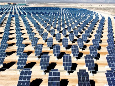

The 140 acre array of photovoltaic panels at Nellis Air Force Base in Nevada generates 14 megawatts of power.
