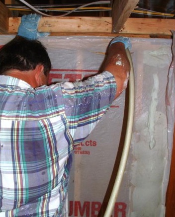

![](http://images.greenbuildingadvisor.com/app/uploads/2018/07/26164239/307_air-krete-main.jpg)
Image Credit: Air Krete, Inc.

Besides polyurethane, there are several other foam-in-place insulation materials. One of these, known as Tripolymer foam, is used primarily to fill concrete blocks in commercial construction. It is made from foamed phenol-urea formaldehyde, so it may release some hazardous formaldehyde into the building—but apparently less than an older formulation of urea-formaldehyde foam insulation (UFFI) that resulted in very significant formaldehyde offgassing.
Finally, there is a foam-in-place, cementitious insulation, Air Krete, that is made from magnesium oxide (derived from seawater) and ceramic talc mined in upstate New York. Air Krete is totally fireproof, mold-resistant, and does not offgas any volatile chemicals, so it is popular among people suffering from chemical sensitivity. Unfortunately, there are few trained installers, so it may be expensive to use this alternative. (The closest installer to Brattleboro is Eco-Safe Insulation in Northfield, VT, near Montpelier; 802-485-9119.) Other than availability, the biggest problem with Air Krete is that the cured foam is fairly fragile; if exposed to frequent vibration, such as along a busy highway, the foam can begin to disintegrate, reducing its performance. The manufacturer is working to solve this problem.

Alex you state that "UFFI is no longer produced." I suggest that you do a little more research before making such a assumption. The process is alive and well in USA, Canada, Europe, United Kingdom, New Zealand and other countries.
Here in NZ it has been operating without problems since 1979.

I'd be interested to know why you think that UFFI is "alive and well in the U.S.A. [and] Canada."
A great many sources can be cited that show your statement to be false. For example, this comes from the "UREA FORMALDEHYDE FOAM INSULATION (UFFI)" fact sheet published by the Connecticut Department of Public Health: "In 1981, as a result of these findings, the installation of UFFI was banned in Connecticut."
http://www.ct.gov/dph/lib/dph/environmental_health/eoha/pdf/uffi.pdf
Here's some information from the Canada Mortgage and Housing Corporation: "During the 1970s, when concerns about energy efficiency led to efforts to improve home insulation in Canada, UFFI became an important insulation product for existing houses. Most installations occurred between 1977 and its ban in Canada in 1980."
http://www.cmhc-schl.gc.ca/en/co/maho/yohoyohe/inaiqu/inaiqu_008.cfm
Can you please name a UFFI manufacturer or UFFI installer in the U.S. or Canada?

Despite being overturned in 1983, the CPSC ban of UFFI in 1982 and subsequent bans and restrictions implemented by a few states attached a stigma to UFFI that is slowly being overcome with advanced chemistry and focused marketing through well trained and equipped authorized contract installers. As a result some UFFI products may be properly described as 'ultra-low emission' foam in terms of their potential to emit free formaldehyde. Some experts, including attorneys, suggest the issue ought be revisited in light of the quality of UFFI available today.

I just had Tripolymer by CP chemical installed in my house and after on week it had shrunk up two 5/8 of and inch from the studs and over and inch on top! After having the installer try to fix it twice I am removing the finished drywall and removing the product completely, and replacing it with some thing that works! I have tried to get in touch with CP via email and phone and they wont get back to me? It also shrunk from the sheathing and drywall creating moisture in the wall. It is now below 0 outside so moisture has formed on the sheathing because of heat loss, remember it disolves with water? Don't make the same mistake I made don't waste your money!

The Tripolymer product was found by Health Canada to contain Urea Formaldehyde. Testing performed for the state of Connecticut confirms that Tripolymer emits significant levels of formaldehyde, nullifying their claims that no formaldehyde is used in the manufacturing process of their foam.
