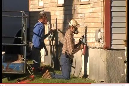

The EPA announced its first enforcement action under the rule in May, for a Maine-based landlord’s failure “to contain dust and debris generated by lead paint removal activities during a repainting project in October 2010.” Two workers hired by the landlord used “power equipment to remove lead paint from an exterior wall of a residential building without using any containment for lead-containing dust and debris,” the agency said in its announcement.
