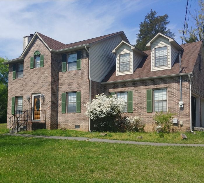

Andrew Bennett is giving his 1991 home in eastern Tennessee an efficiency upgrade, as time and budget permits. He has a long list of improvements he’d like to make—new windows, sealing and insulating the crawlspace, more air sealing around the house—but he’s also realistic enough to see it will not happen overnight. “As most normal people,” he says in a recent Q&A post, “I’m on a budget and it will take time.”
For now, he’s focused on the best way to replace an old gas water heater and his HVAC system. The 1900-square-foot house is currently served by a single-zone, 3.5-ton HVAC system with a gas furnace. Bennett has found a contractor who’s made some recommendations for new equipment.
“It took a while to find someone who actually knows how to size things and they are looking at a 2-ton unit with a variable speed blower,” Bennett writes. Plans call for a second thermostat upstairs, but budget constraints are forcing Bennett to reuse existing ducts even if they aren’t suited to the smaller HVAC system.
“My question on HVAC is should I go all electric or stay with gas heat?” Bennett asks. “I don’t have solar and have no plans or budget for going solar for electricity generation.”
Second, Bennett wonders what to do about his gas-fired water heater. Although it still gets water hot, it also “intermittently spews out a black, oily residue.” Should he simply replace it with another gas water heater? He’s not convinced that heat-pump water heaters will last 10 or more years without significant repairs along the way, and he’s leery of tankless heaters for the same reason.

This is the home owner. I wanted to give an update. I still don't have the system replaced yet. My usual HVAC contractor simply refuses to put in a 2 ton unit. I decided to pay for an independent manual J and used rescheck.info. It turns out the guy who does the calcs is right here in East TN as well as has a house about the same size as mine...and has a 2 ton unit and he says it's fine.
So he did the manual J. We fudged some numbers as I'm planning on more insulation, windows, etc long term. His calcs came out with a 2 ton system as well. Based on the comments of Akos on the original post I decided to have the Carrier guy come out and give me a price on a Greenspeed unit.
He took a look at the Manual J and said it all looked pretty good except for the indoor and outdoor temps he used at 75 degrees inside and 90 outside. He knew off the top of his head how many cooling days we had the last two years that were well over 90 and wondered if the 75 degree indoor temp was really what would keep me comfortable (and I do like to sleep in a cold house).
So...I emailed rescheck.info back and asked him to raise the outdoor temp to 95 and drop the indoor to 70. That was enough to bump things to 2.5 tons. As you know 2.5 ton systems are only available in single speeds. If I want a multi speed system I'd have to go to 3 tons. The Carrier guy also says that the Greenspeed system won't work with my ducts. He says there's some sort of sensor that checks the static pressure and mine would be (I really don't remember if it was too high or too low, but it wouldn't be right) off and the system just wouldn't run right.
I think he gave me some good insight on the furnace part of the deal. If I am running a heat pump the furnace just isn't going to be on much at all so having a modulating, multi-speed system might not make a lot of sense from a cost perspective based on how little it would run.
As far as the heat pump portion of it I could go with a 2.5 ton single speed system where the ductwork would need a bypass or a 3 ton multi-speed (I don't remember if it would need a bypass or not to keep the duct pressure in the right range...remember currently I have a single zone for the whole house, but am planning on putting in another thermostat and dampers to have 2 zones).
The 3 ton would have a nice dehumidification feature that the 2.5 ton would not...but it would add about significantly to the price for the multi-speed unit.
This is making me want to pull my hair out. I wish I had the money to do all the energy upgrades I want up front and maybe get the manual J back down to 2 tons, but I just don't have the budget.
To address Peter Yost's comments about why I'm doing the HVAC first before working on the building enclosure...we've lived in the house for 5 years. The condenser has gone out every single year and both I and my wife are sick of that. So the replacement has to come first.
Any additional input is gladly appreciated. Thank you all. Andrew
