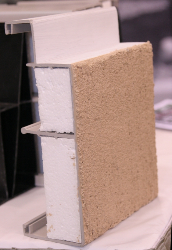

PVC concrete form protects foam insulation
Energy edge is a PVC form with integral 2 in. expanded polystyrene (EPS) foam board (R-8). It forms and insulates the slab while protecting the insulation. The PVC is recycled from post-industrial waste — floor scraps.
Instead of setting up 2×8 forms, adding foam, pouring the concrete, and then stripping the forms, with Energy Edge, you set up the forms and pour. Installation is a lot faster and easier than the alternative too. “This product is ideal for sitting on top of a concrete block stem wall because, assuming you put foam under the slab, it encapsulates the slab and removes the need to add foam to the outside of the foundation.” says consulting editor Michael Chandler, a builder in Chapel Hill North Carolina. “And the top edge of the form is great for screeding the slab — The concrete guys are gonna love this stuff.”

Stucco doesn’t stick to PVC
Chandler likes to use hard coat stucco to finish his slab foundations because it is more durable and much cheaper than synthetic stucco coatings. The problem is bridging the two materials—stucco won’t stick to the smooth PVC surface. While synthetic stucco can bridge the two different materials (PVC and concrete block) hard coat stucco needs a lath substrate to stick to the PVC.
