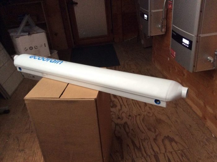

The EcoDrain is a wastewater heat recovery device that replaces a section of horizontal drain pipe. The devices enables heat from water flowing down the drain to be transferred to cold water flowing toward a shower valve.
David Velan of EcoDrain paid us a visit here at South Mountain so my colleague Brice Delhougne and I could see his product firsthand. A few years ago David got interested in capturing the waste heat in shower water and other hot waste water. Others have done that (PowerPipe) but they have been limited to applications where the vertical heat exchanger, usually 4 to 6 feet long, can fit, and still be higher than the wastewater outlet from the building.
EcoDrain’s innovation is a wastewater heat exchanger that can be mounted horizontally.
In the photo above, you can see the inlet and outlet, which are 2-inch-diameter PVC, and the side taps for the inlet and outlet for the potable water. The unit is about 56 inches long. The flow is countercurrent: the wastewater on top flows one way, and the potable water below flows in the opposite direction and picks up heat across the copper interface. Depending on the relative flow rates, and the pitch of the unit, the EcoDrain recovers 30-45% of the energy in the wastewater.
David went through many evolutions before arriving at his product. It has a double-wall heat exchanger configuration that should satisfy codes (the product has a UPC acceptance) and square section tubes on the potable water side to maximize heat exchange contact area. The upper portion of the unit is PVC and is smooth to minimize any buildup of solids.
The photo at left shows a cross section.
One of the EcoDrain innovations is seen in each square tube: a plastic insert designed to keep the flow highly turbulent to increase heat transfer.
The bottom of the unit has a drain hole so that any leaks become obvious quickly.
The unit is designed to work with very slight pitch, like a typical plumbing waste line, but it can be pitched at more severe slopes, and the increased velocity of the wastewater increases heat recovery.
The unit can be plumbed so that the preheated water flows to the cold side of the shower, or to both the shower and the cold inlet of the water heater. The latter equal flow configuration will harvest the most BTUs.

"Depending on the relative flow rates, and the pitch of the unit, the EcoDrain recovers 30-45% of the energy in the wastewater."
Unlike the gravity-film vertical types, at very low flows the recovery efficiency of the EcoDrain may go down at some low-flow point, since unlike the gravity film units it relies upon turbulence for heat exchange efficiency. I've watched this company since pretty near their beginnings (with an all-stainless steel design), but have yet so see much in the way of performance data, and it would be important to know where the inflection points are in the curves relative to flow & pitch. A 30-45% difference in recovery efficiency is a significant range- if there are good / better / best flow rates & angles, shouldn't that be published? (I think most of us would prefer to set up up for 45% efficiency rather than 30%.) On page 3 of the installation manual it states:
"Note that heat transfer performance will increase as the tilt angle
increases. This can boost heat exchanger performance by 5%-10%. The
reason is that at a higher tilt angle, the waste water travels faster.
This generates turbulence in the waste water flow and as a result the
waste water gives off heat at a higher rate. With the A1000 unit, a
maximum slope of 75o is recommended to allow an efficient heat transfert. " (sic)
( https://ecodrain.ca/media/products/ecodrain-installation-manual.pdf )
A 75 degree tilt is significant- if that's what it takes to hit 45% efficiency there will be many installations that will have to settle for less, but it would be good to know how much you're giving up with every 5 degrees of tilt lower than that very crooked nearly vertical angle, and how much is given up by going with unbalanced flow (option A, on p.1 ) vs. balanced flow (option B).
