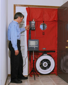

Frank O’s new house is tight — very tight. Tests by an energy auditor measured 0.13 air changes per hour at 50 pascals of depressurization (ACH50), meaning the house beats the very stringent airtightness target of the Passivhaus standard.
Frank O has installed a heat-recovery ventilator (HRV) to provide fresh air as well as fans for spot ventilation and a range hood fan rated at 189 cubic feet per minute (cfm).
Sounds perfect. So what’s the problem?
“The auditor and I also played with the spot ventilation fans and his manometer, and we were able to reach -46 pascals with all house fans on and the electric clothes dryer on,” Frank O writes in his Q&A post. “My concern is: with such a tight house, where does the air come from during spot ventilation and clothes drying?”
Are the numbers right?
J Chesnut’s first question is whether the auditor has calculated air leakage correctly.
“Are you sure you calculated your ACH number correctly?” he asks. “It is not unusual for someone to determine the volume of the building incorrectly and therefore miscalculate the ACH from the cfm reading.
“The tightest among Passivhaus builders in the U.S. I am familiar with is .15 ACH and I heard this was possible to attain because it was a mid-sized commercial building (apparently the smaller the building the more difficult it is to get a low ACH).”
In a subsequent post, Frank O confirmed Chesnut’s suspicions. It turns out that his house tested at 2.14 ach50, not 0.13 ach50. So Frank O’s house isn’t quite as tight as his first post claimed.

--At ACHnat of 0.13, a 2700 SF house with 8 ft ceilings has 21.6K CF which ventilates naturally at 2808 CF per hour or 47 CFM (albeit more on windy days and less on calm days), enough to handle those spot ventilation fans. As you correctly point out, tighter houses and larger exhaust fans can pose imbalances requiring makeup air. I recall Dr. Wolfgang Feist once proposed a solution whereby a clothes dryer exhaust could be run through an HRV, recapturing 80%+ of the heat. Dr. Feist, perhaps could you help us out re the specifics of this idea; how does it balance the air flows?

Strong depressurization can unbalance an HRV system and cause the HRV inlet to leak. But an HRV system is not designed to provide makeup air, and should never be depended upon to supply makeup air.
HRV manufacturers are explicit about this fact in their instructions. They advise installers that if you need a makeup air system (for example, to provide combustion air to an atmospherically vented appliance), then you need to install a separate makeup air system, since HRVs are NOT designed to provide makeup air.
