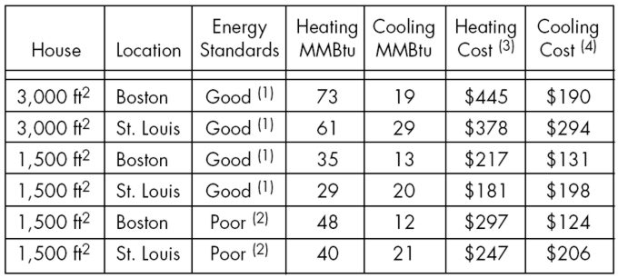

Even if a small house has lower levels of insulation than a larger house, it's likely to cost less to heat. 1. R-19 walls, R-30 ceilings, double-low-e (U=0.36) vinyl windows, R-4.4 doors, infiltration of .50 ACH, and R-6 ducts in attic; 2. R-13 walls, R-19 attic, insulated glass vinyl windows, R-2.1 doors, infiltration of .50 ACH, and uninsulated ducts; 3. Natural gas at $0.50 per therm; 4. Electricity at $0.10 per kWh.
Image Credit: Environmental Building News, January 1999. Energy data from Andy Shapiro, Energy Balance.

When someone is considering building a green home, my first, number-one recommendation is to keep the size down. Since 1950, the average house size in the U.S. has more than doubled, while family size has dropped by 25% — so we’re providing 2.8 times more area per person than we were back then. If you think you need a 3,000 square-foot house, consider whether 2,500 would suffice, or even less. There are some really great homes being built at 1,400 to 1,500 square feet — homes where every square foot is optimally used and there aren’t rooms, like formal dining rooms, that sit empty most of the time.
Often, because we’re conditioned to think that bigger is better or because we’re told by a real estate agent that a house has to be large to keep its value, we build the largest home possible. By stretching budgets to maximize square footage, we’re then often forced to skimp on quality and performance. If, instead, we downsize the house, we can improve its quality (durability, detailing, energy efficiency, green features), and we might even be able to reduce the overall costs.

When it comes to energy, building a green, energy-efficient house usually does increase costs. But we can significantly reduce that extra cost — occasionally even eliminate it — by practicing “integrated energy design.” If we spend more money on the building envelope (more insulation, tighter construction detailing, and better windows) so that we dramatically reduce the heating and cooling loads, we can often save money on the heating and cooling equipment. With a really tight, energy-efficient house, for example, we might be able to eliminate the $10,000 to $15,000 distributed heating system in favor of one or two simple, through-the-wall-vented, high-efficiency gas space heaters, or even a few strips of electric resistance heat.
If, along with that really well-insulated envelope, we carefully select east- and west-facing window glazings that block most of the solar gain and provide natural shading from appropriately planted trees, we might even be able to eliminate central air conditioning.
These savings on mechanical equipment can cover a lot of the added cost of the improved building envelope. In rare cases, these savings in heating and cooling equipment (if we eliminate a really expensive system, such as a ground-source heat pump, for example), we can pay for all of the envelope improvements and even reduce the total project cost.
