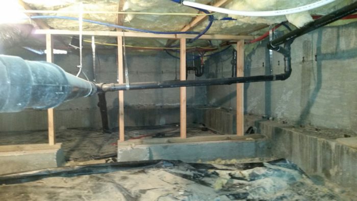

Michael Geoghegan is designing a house for a mixed, humid climate and he plans on using an insulated crawl space.
Advanced Energy, a regional energy consulting firm, has published a report on crawl spaces which suggests a dehumidifier can be used as an alternative to providing code-required supply air to condition a crawl space. “I’m a little bit concerned about cold floors in the winter time with this method,” Geoghegan writes in a Q&A post at GreenBuildingAdvisor. “Does anyone have any experience here?”
Detailing crawl spaces correctly isn’t simple. A recent Q&A Spotlight focused on methods for insulating a crawl space, and Geoghegan’s question — “What’s the best way of ventilating a sealed crawl space?” — raises overlapping concerns.
In this Q&A Spotlight, the discussion quickly turns to a broader issue: Are crawl spaces a good idea in the first place? Although they are common in the southeastern part of the U.S., they are rarely used in the Northeast, where full basements are the norm and crawl spaces are an anomaly. Who’s right?
Crawl spaces need an exchange of air
A dehumidifier might be useful for lowering humidity levels in a crawl space temporarily, says GBA senior editor Martin Holladay, but there should be no need to for a dehumidifier to become a permanent crawl space fixture. Because dehumidifiers use a lot of energy, it would be better to remove the dehumidifier once the crawl space has dried out.
Long-range, the question becomes how best to comply with a building code requirement that a sealed crawl space be conditioned. There are two code-approved approaches, Holladay says. Both approaches require the installation of a floor grille to connect the crawl space air with the conditioned home above the crawl…

As to the original question about using a dehumidifier to meet ventilation requirements in a crawl space. The option for conditioned air supply would allow a dehumidifier as the code defines conditioned air as “air treated to control its temperature, relative humidity or quality.“ A humidity control system controlled by a dehumidistat in the crawl space is a big plus over a ventilation system whose effectiveness is dependent on the ac system being set up in a manner and used enough to adequately control humidity. If the paths of moisture entry are controlled, even the smallest portable dehumidifier is overkill. Although humidity can be controlled without a dehumidifier in cool moist climates one would be a better way to appease inspectors than installing ventilation that tends to increase humidity. Unfortunately following code to the letter would require a ducted whole house type with a return path through the living area. They’re energy hogs when windows are used for cooling and fresh air.
There should be no need to regularly supply fresh air to a crawl space. Fresh air requirements are based on the principal that spaces only need ventilation when occupied by people. Only PETA should be concerned about the air quality of vermin in the crawl space; but there should be any pests if it’s closed up anyway. On the rare occasion someone is doing work in the crawl space it would be good to have a second hatch, for both access and ventilation. Where soil-gas issues exist they are better addressed with sub-membrane depressurization or a wide open pier type foundation than a minimally vented crawl space.
I wish supposed experts would stop perpetuating the myths that dead air causes mold and fresh air needs to be circulated though crawl spaces to prevent fungal problems. These myths have caused more damage to buildings than they have prevented, and largely kept a high quality and affordable foundation system out of the northern half of the country.
Another stray thought. When using a forced air ac system for conditioned air supply, you want to deliver warm dry air to the crawl space not cool dry air. Warming surfaces of concern to at least little above the dew point is an important component of moisture control. Better drying could be achieved by supplying air from a grate near the ceiling and transfer duct to the crawl space with a return duct from the crawl space to the air handler. Such a setup could also be sized up to warm the floors in winter without over cooling the crawl space in summer.
